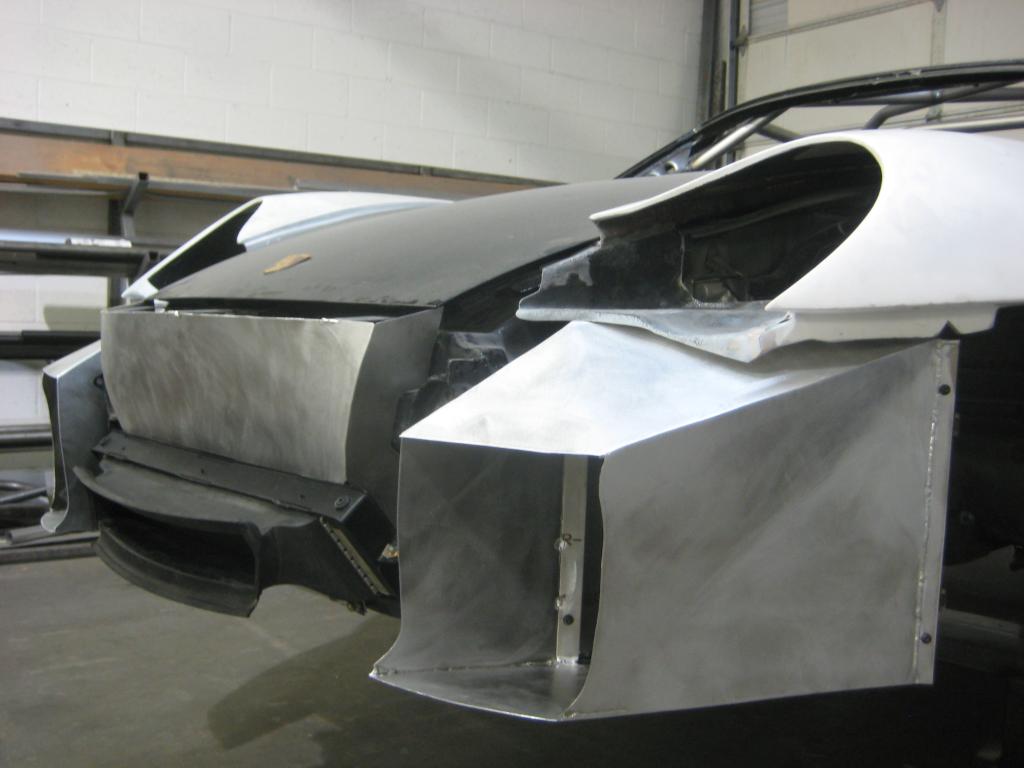

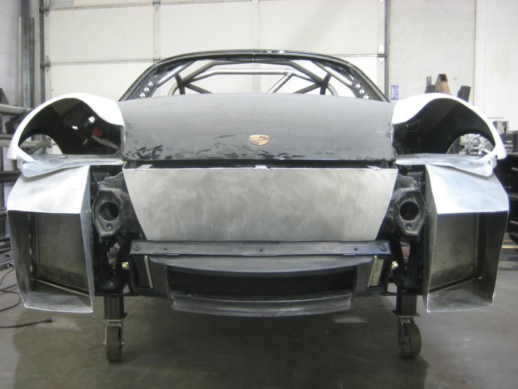

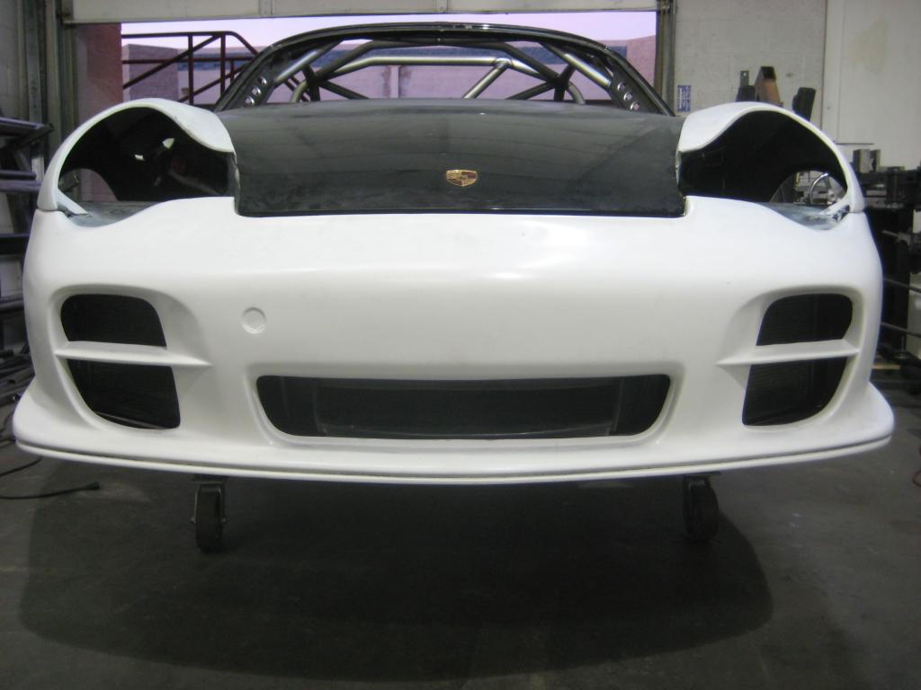

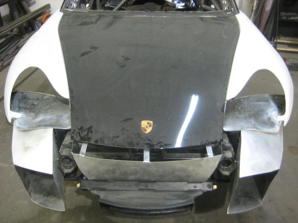

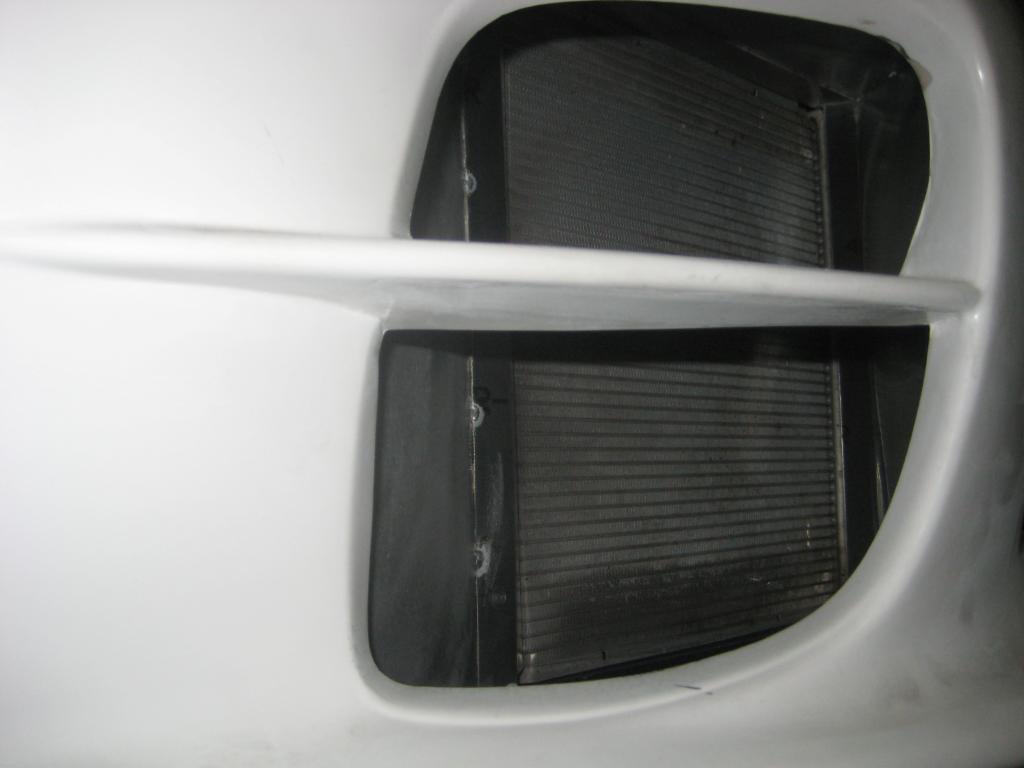

So one of the things I have been dreading ever since I decided to run the wide body GT2 front end is the radiator duct situation. There are two ways to go about it, the expensive way, and the time consuming way. I chose the latter for two reasons. The first reason is the cost of converting the radiators and related duct work to the Turbo/GT2 spec. Basically, that would mean all three turbo 996 radiators, GT2 air ducts for all 3 radiators, radiator mounting brackets for all 3 radiators, and matching cooling lines along with other misc. hardware. Yeah, it's expensive... like a few thousand dollars. Not in the budget for this car. The other reason I decided to stick with the stock Boxster radiators is I want to be able to test the cooling capabilities of the stock Boxster cooling system with the extra horsepower and potential heat that the turbo motor might create. So here is what I came up with...

The side radiators are in the stock location using the stock mounting brackets. The center radiator mounts upside down using a slightly modified stock mounting bracket and the stock plastic duct. In stock configuration, the Boxster S and 996 radiator would vent down below the car through holes in the bottom of the bumper cover. Aerodynamically this is less than ideal which is why the GT3, RSR and GT2's vent up through a hole on the top of the bumper cover. What this means is I had to move the center radiator forward and angle it up to make room for some duct work that would direct the air up instead of down.
