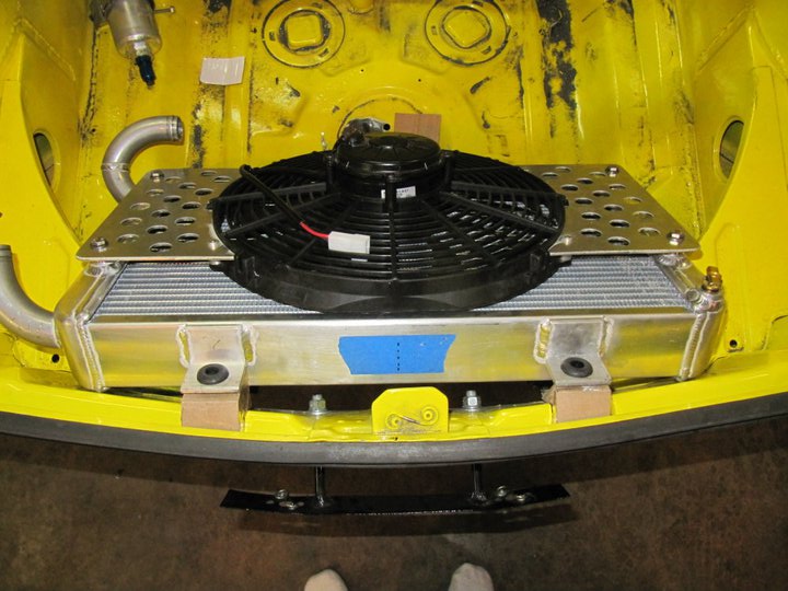

Couple of updates while the engine is out a shop getting all the exhaust tig welded.
Some of you might have noticed in the previous picture of the radiator that the fan was mounted about an inch from the radiator. Not sure why they built it that way, but I modified the fan mounts to move it about 1/4" from the radiator. This will be much more efficient. I also had some tabs welded on for the mounts to the chassis.
(IMG:http://www.914world.com/bbs2/uploads_offsite/l7.sphotos.l3.fbcdn.net-364-1292438351.1.jpg)

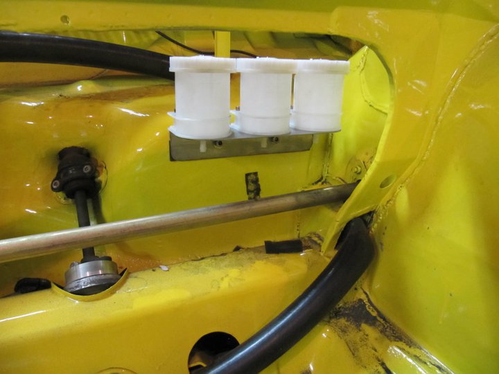

Also made a bracket to hold the three master cylinder reservoirs in the front. I am mounting a Tilton brake pedal assembly and converting the clutch to a hydraulic throw-out bearing hence the need for this set-up.
(IMG:http://www.914world.com/bbs2/uploads_offsite/sphotos.ak.fbcdn.net-364-1292438352.2.jpg)
