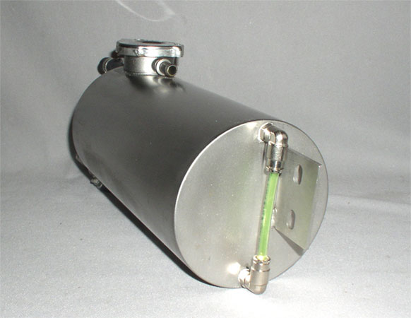

Quick question...for the fuel tank I would like to be able to determine the fuel level without having to put a stick in there. Does anyone know where I can get one of those liquid level sight tubes like the one below...preferably in aluminum and compatible with fuel.

McMark   There's one on this site that has a thermomete...   Dec 18 2010, 11:59 PM

jd74914   Don't use PVC tube. It will melt! (Edited ...   Dec 19 2010, 09:13 AM
McMark   Hmmm, I found a ton of different references to usi...   Dec 19 2010, 01:43 PM
jd74914   Wow...I think I read PVC this morning and thought ...   Dec 19 2010, 05:19 PM

roadster fan   For the fuel site gauge look at custom motorcycle ...   Dec 20 2010, 02:41 PM
