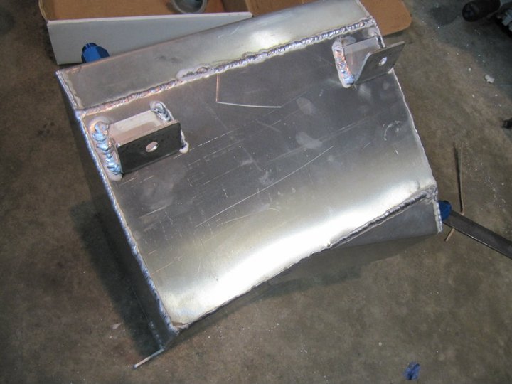

First off, I had the backside of the fuel tank welded up and some tabs mounted.
(IMG:http://www.914world.com/bbs2/uploads_offsite/sphotos.ak.fbcdn.net-364-1292923119.1.jpg)

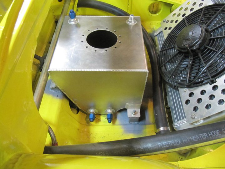

With a set of brackets made, the fuel tank now fits perfectly in the available trunk space.
(IMG:http://www.914world.com/bbs2/uploads_offsite/sphotos.ak.fbcdn.net-364-1292923119.2.jpg)

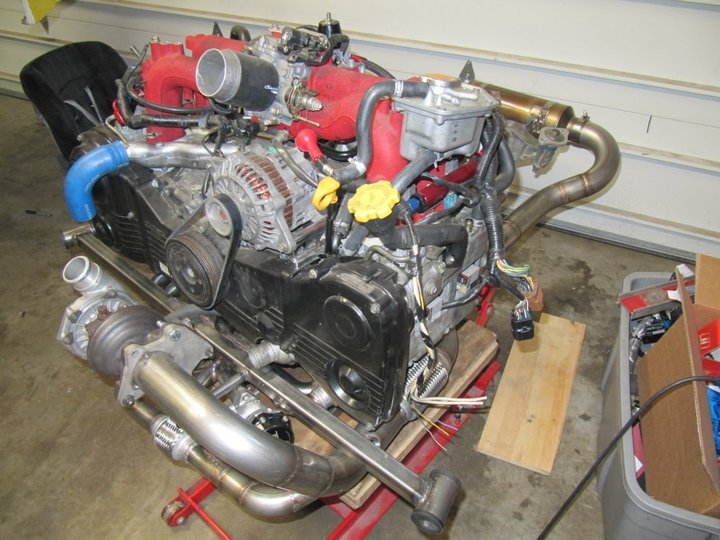

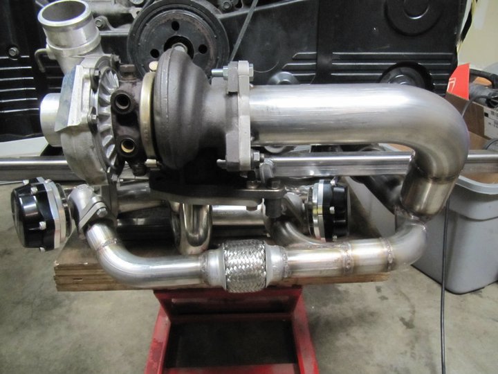

I also got the engine back to my garage after having all the exhaust all tig welded up. I added a flex joint in-between the two wastegates to aid in installation.
(IMG:http://www.914world.com/bbs2/uploads_offsite/sphotos.ak.fbcdn.net-364-1292923119.3.jpg)
Overview shot of the engine...almost ready to go, just a few more things to do.
(IMG:http://www.914world.com/bbs2/uploads_offsite/sphotos.ak.fbcdn.net-364-1292923120.4.jpg)

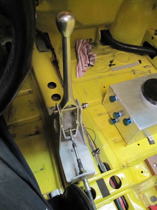

Some of you might know, but I have a special 2-speed transmission in this car. In addition, the placement of the header and turbo make it virtually impossible to pass a shift bar through to the transmission. Therefore I have converted to a cable shift set-up. Here is my new shifter I built today.
(IMG:http://www.914world.com/bbs2/uploads_offsite/sphotos.ak.fbcdn.net-364-1292923120.5.jpg)
I will need to have a pair of small spacers made tomorrow at the machine shop to correctly position the hem joint, but the functionality works. Here is a short video of the motion.
Britain's Shifter Motion

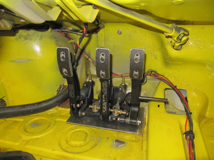

Finally, I started working on the placement of the pedal assembly. Does anyone have any experience with mounted a set of these on the uneven floorpan. I haven't decided if I want to mount them to the aluminum or just cut out the raised portions of the floorpan and weld in a flat panel.
(IMG:http://www.914world.com/bbs2/uploads_offsite/sphotos.ak.fbcdn.net-364-1292923120.6.jpg)
