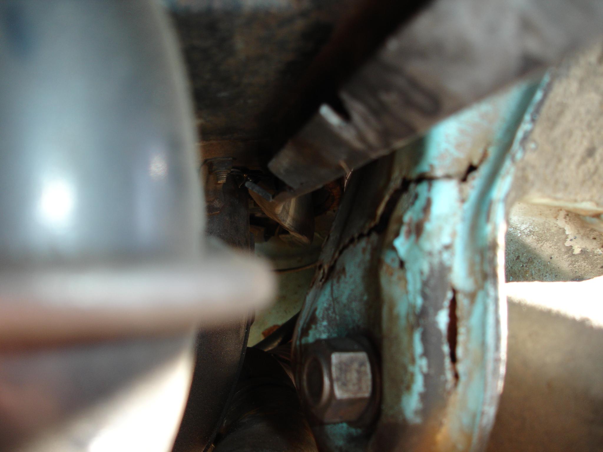

im totaly bummed out about this. after about 50 hours of research and electrical work on my new toy, i found this while hooking up my fuel line.
its really bad. to the point where i dont think its safe to drive the car.... (IMG:style_emoticons/default/headbang.gif)
do you guys think this is something i should try fix this myself and box it in? im not sure my fab skills are up to the task....
or should i leave this one up to the professionals? is there a shop in so cal. that is competent enough to fix this? forgive my noobieness for not knowing any shops around. i'm not out to insult anyone. i just dont want a hack job. i could do that myself. LOL

wow, im not the only one with this problem. im going to check out your thread know. thank you. i googled 914 suspension console repair and got a bunch of hits. i helps to use the correct terminology.

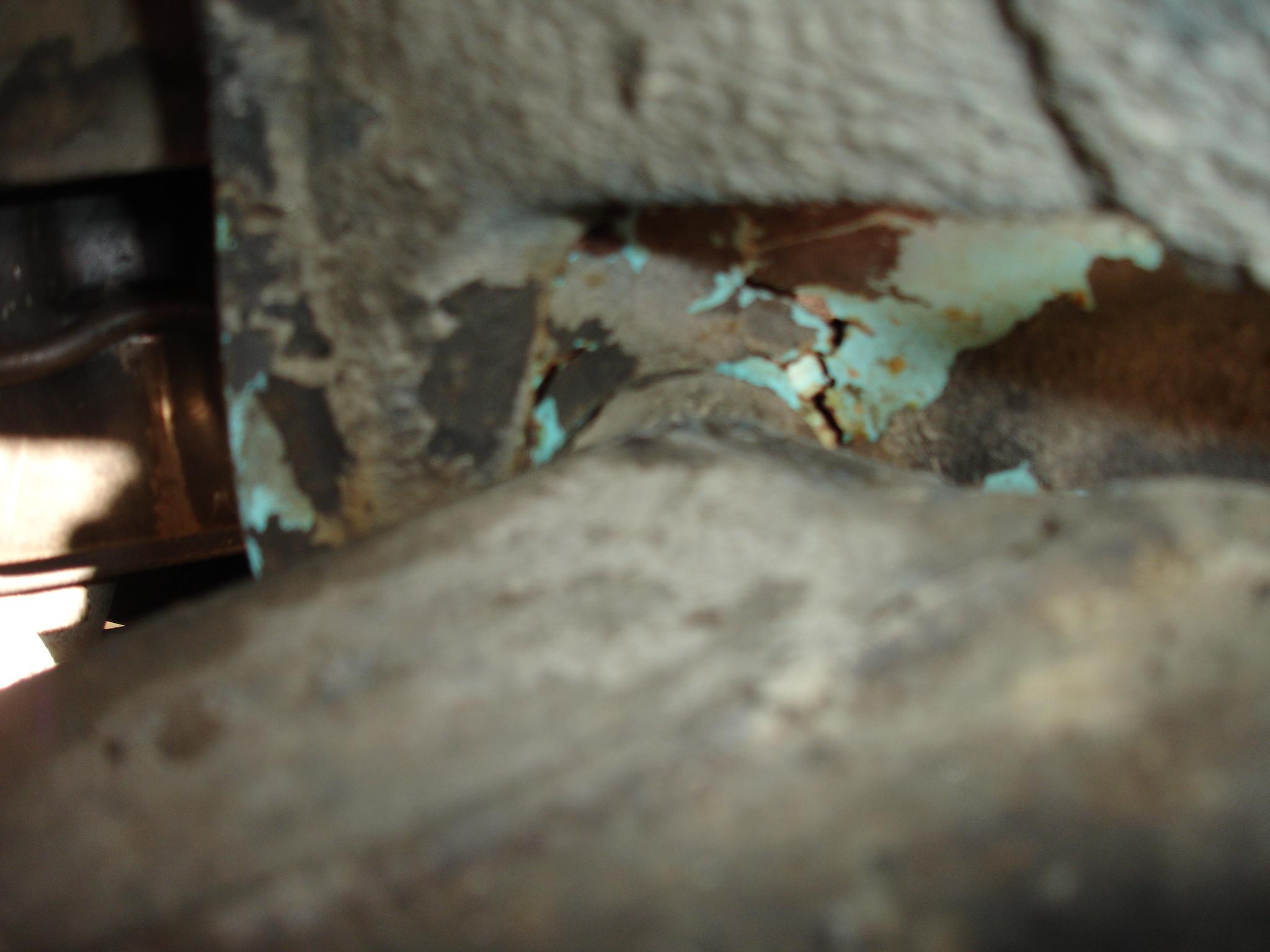

mrbubblehead   heres another shot.   Dec 27 2010, 02:50 PM
Tom_T   Better check the other side too! <_< I...   Dec 27 2010, 03:00 PM
dr914@autoatlanta.com   don't be bummed! Happens all of the time...   Dec 27 2010, 03:02 PM
SirAndy   its really bad. to the point where i dont think it...   Dec 27 2010, 03:02 PM
mrbubblehead   its really bad. to the point where i dont think i...   Dec 27 2010, 03:15 PM
Joe Sharp   We have a friend in your neighborhood that can hel...   Dec 27 2010, 04:09 PM
stugray   That looks very familiar: http://www.914world.com...   Dec 27 2010, 04:15 PM
mrbubblehead   wow, im not the only one with this problem. im goi...   Dec 27 2010, 04:22 PM
SirAndy   wow, im not the only one with this problem. im go...   Dec 27 2010, 05:05 PM
sean_v8_914   I have posted at least 3 of these repairs here and...   Dec 27 2010, 05:41 PM
sean_v8_914   the driver side is not available and must be fabri...   Dec 27 2010, 05:47 PM
sean_v8_914   bvmncgh   Dec 27 2010, 05:55 PM
sean_v8_914   mn,   Dec 27 2010, 05:57 PM
sean_v8_914   whoever welds it up: be sure they passivate the ru...   Dec 27 2010, 05:58 PM
mrbubblehead   thanks alot sean. a picture is worth 1000 words.   Dec 27 2010, 06:10 PM
mrbubblehead   well, im doin it fellas. i replaced the rear conso...   Jan 6 2011, 10:38 PM
