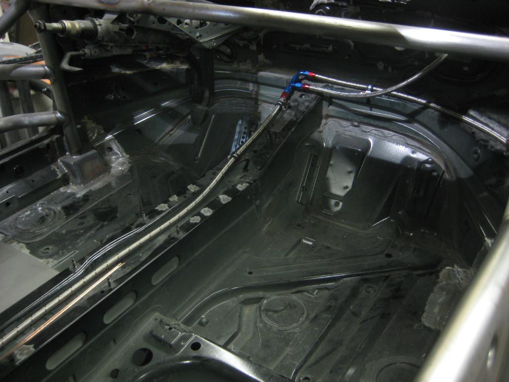

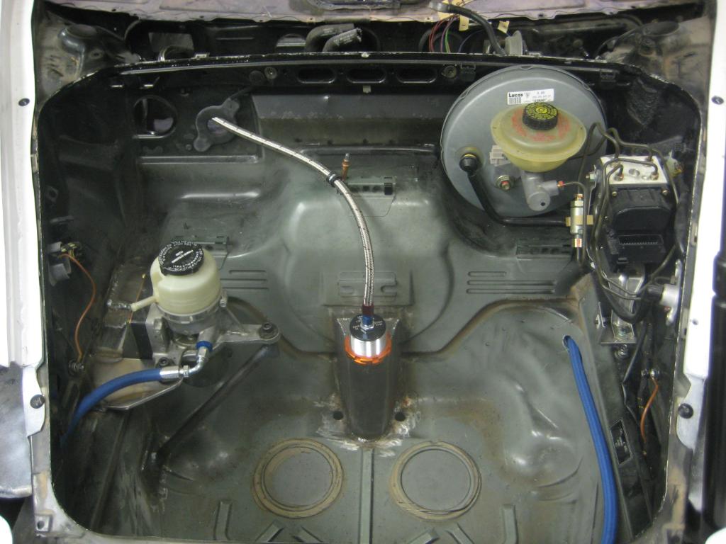

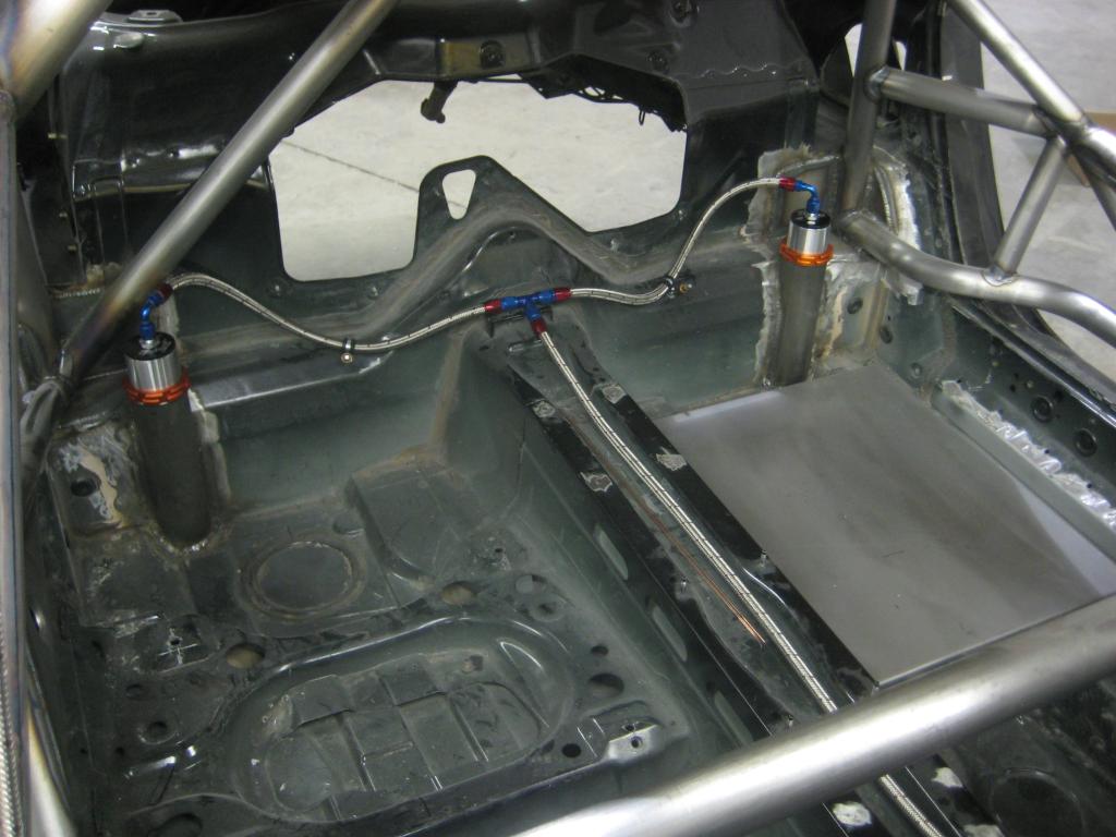

Plumbed the air-jacks and started on the electronic power steering conversion. Both are almost finished, just need to get a few more fittings.
