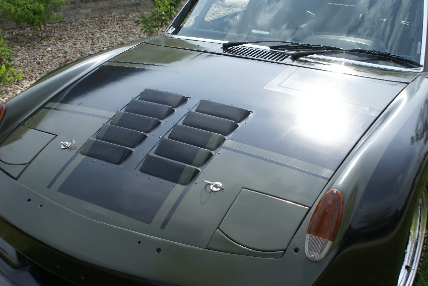

As promised here are a few detailed pics of the cars current state.
The radiator will be completely shrouded once finished.

Hey Fasthonda,
I love your converion and compliments on the good work! It's a great conversion idea and with such a stout engine, I'm wondering about supercharging!
That you really make it fly!
My car is a V8 conversion and I also had to raise the engine cover....it isn't even noticeable!
When I noticed your radiator install, I believe I saw that your plan to vent out the bottom of the car. I wanted to pass on that I tried this for a couple years with my car and even with an airdam 2" from the ground and 2 big fans, the car still ran HOT on-track. Most of V8 conversions exhaust out the fenderwells and while it seems to work, the BEST way is our the top of the hood. Check out what bynbad914 has done in the attached photo. My solution is similar ala racing sports cars. Since the Honda won't be producing the heat of my 383 Chevy, a modest opening should to the job.
Best of luck, keep the photos coming!!
Terry

QUOTE(stewteral @ Dec 27 2010, 08:58 PM) *
Thanks for the advice Terry. From reading the forums I was aware of this, but not until after I finished my original setup. I gonna give this a try and monitor the water temp closely. It won't take too much to angle the radiator forward and vent out the hood if neccesary. Plently of good deals on Ebay for Louvers.

Hey Michael,
I certainly understand the issue of making a conversion work: there are so many details for "engineer" one's way through and when done, I find myself thinking: "If I were to do it again, I'd do a lot of things differently!"
A suggestion for bottom exhausting: be sure to install a serious chin spoiler to create a low-pressure area under the car and aid radiator exhausting. For the lower 3" of mine, I used kitchen floor coving: cheap, black flexible plastic and stiff enough to do the job.
In the case of my Chevy, I found another negative in using the low chin spoiler, however: It reduced the airflow under the car that comes UP in the engine bay and cools the engine block. I was surprised to learn that even though the Chev is "Water Cooled", 30 % of cooling still comes from air across the engine. How important to your Honda this is will be your challenge to determine.
A hard lesson I learned in my project that it is all about the complete package working as a whole.
If you forget the bottom-exhausting and want to maintain the Sleeper Image, there is still the choice of venting out the fenderwells.
Regardless of how you exhaust, I had an engineer bud beating me in the head to DUCT the AIRFLOW. He pointed out that ducting improves the efficiency of flowing the airflow and reduces issues of vortices blocking flow.
BTW: If you decide to vent our the top of the hood, I understand Bynbad914 found his louvers on Summitracing.com.
Best of luck,
Terry
