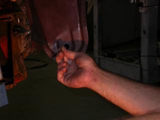

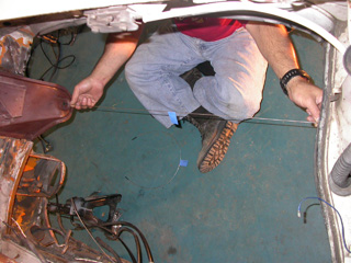

ear to ear is less critical than ear to pin hole in center of firewall about 1/2 way up

sean_v8_914   I have posted at least 3 of these repairs here and...   Dec 27 2010, 05:41 PM
sean_v8_914   the driver side is not available and must be fabri...   Dec 27 2010, 05:47 PM
sean_v8_914   bvmncgh   Dec 27 2010, 05:55 PM
sean_v8_914   mn,   Dec 27 2010, 05:57 PM
sean_v8_914   whoever welds it up: be sure they passivate the ru...   Dec 27 2010, 05:58 PM

sean_v8_914   missing the plate that bridges he two ribs togethe...   Jan 7 2011, 09:52 AM
sean_v8_914   ear to ear is less critical than ear to pin hole i...   Jan 7 2011, 10:00 AM
mrbubblehead   ear to ear is less critical than ear to pin hole ...   Jan 7 2011, 11:49 AM
