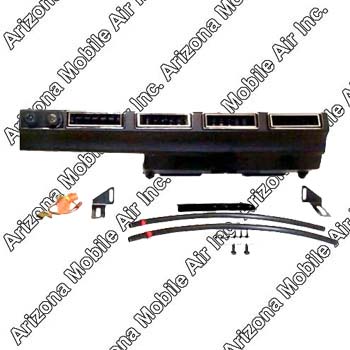

The evaporator I'm using is a slimline underdash unit with heat and A/C . It also has a defrost where it directs air to a set of vents. I have these going to the stock 914 defrost vents.
