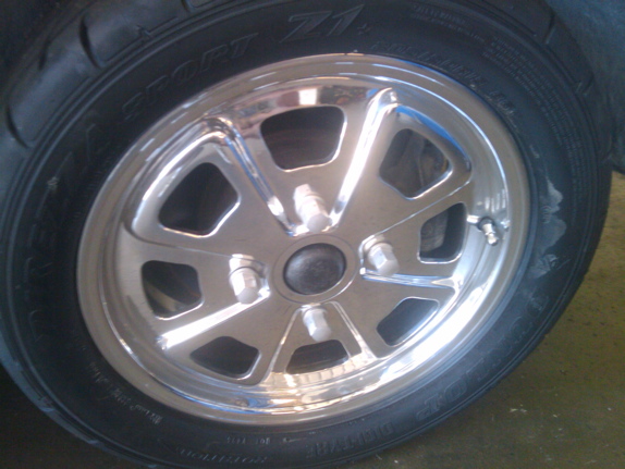

On the 8 spoke Empi knock offs they have a bigger offset with less back spacing so unless you massage the fenders and roll the fender lips, you will be limited to probably a 195x60 or 65x15
I am running Dunlop Direzza Star Spec Z1s in 205x50x15 and absolutely love them...great grip... But I don't think they come in a size that you would need with your wheels. Attached image(s)
