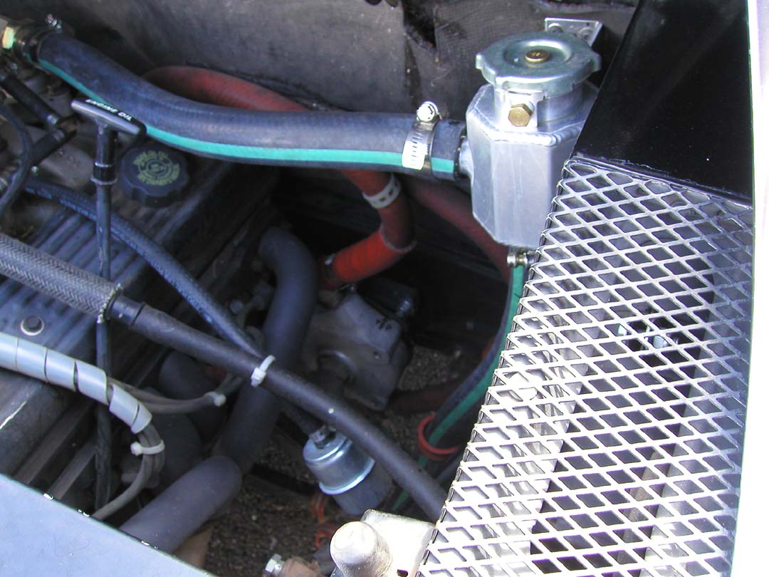

Brad and Chung installed the RH rad in my car and can say it works well. I did overheat going up the hills recently and Scott of Renegade attributed it to the RS water pump. I run the Dedenbear inlet on top of the motor but it limits my air filter choices so I plan to convert to RH. Here's some pics...

neo914-6   Someone's front mounted expansion (RH also)...   Mar 30 2004, 12:24 AM
