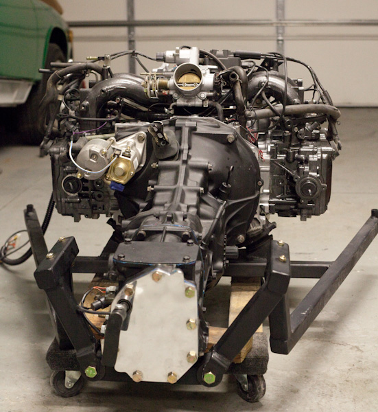

Next step, make a flat cover plate.

Interested in how you do the plate. I would entertain the money they want for the adaptor but 200 plus for the plate seems high.

The plate is pretty simple. I just used 1/4 aluminum I picked up at my local scrap yard. I used the differential housing that I removed from the tail of the trans as a template by setting it on the plate, tracing the outline and marking center of holes. You can eliminate the top right and bottom left alignment pins. I just cut my alignment pins off but kept the shape in the plate. The shift rod takes a little bit of time to get right, it is an oval because of the angle. I just used a die grinder to get the right shape. I polished the plate just because, not sure I'll keep it that way but I'm starting to like it. DBCooper's wrx thread has a very nice plate complete with a cnc logo.
