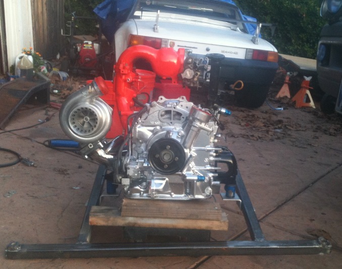

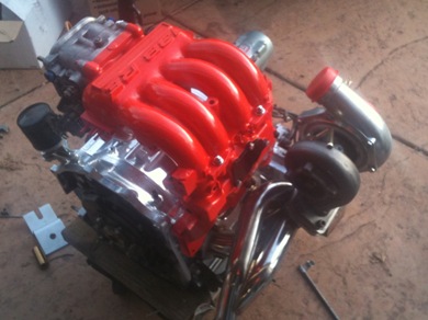

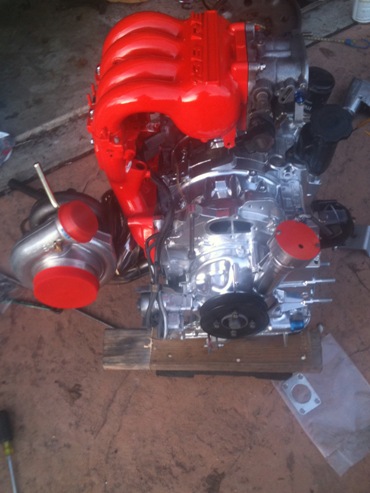

Quick update... Home refi has slowed down my purchase power but here's some update pics...
Working on my cradle. 1.25 square tubing 0.120 wall. Waiting for my adapter plate and flywheel before final fab.
