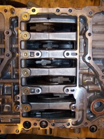

bfrymire   Forgive me for my ignorance about the SVX motor. ...   Feb 23 2011, 08:32 PM
BIGKAT_83   Forgive me for my ignorance about the SVX motor. ...   Feb 24 2011, 12:59 AM
bfrymire   Great! Thanks for the info. Looks like I am ...   Feb 24 2011, 01:38 AM
