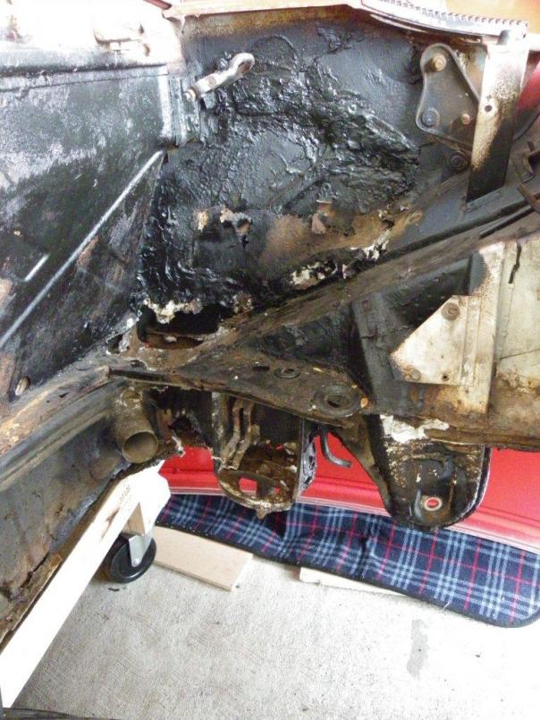

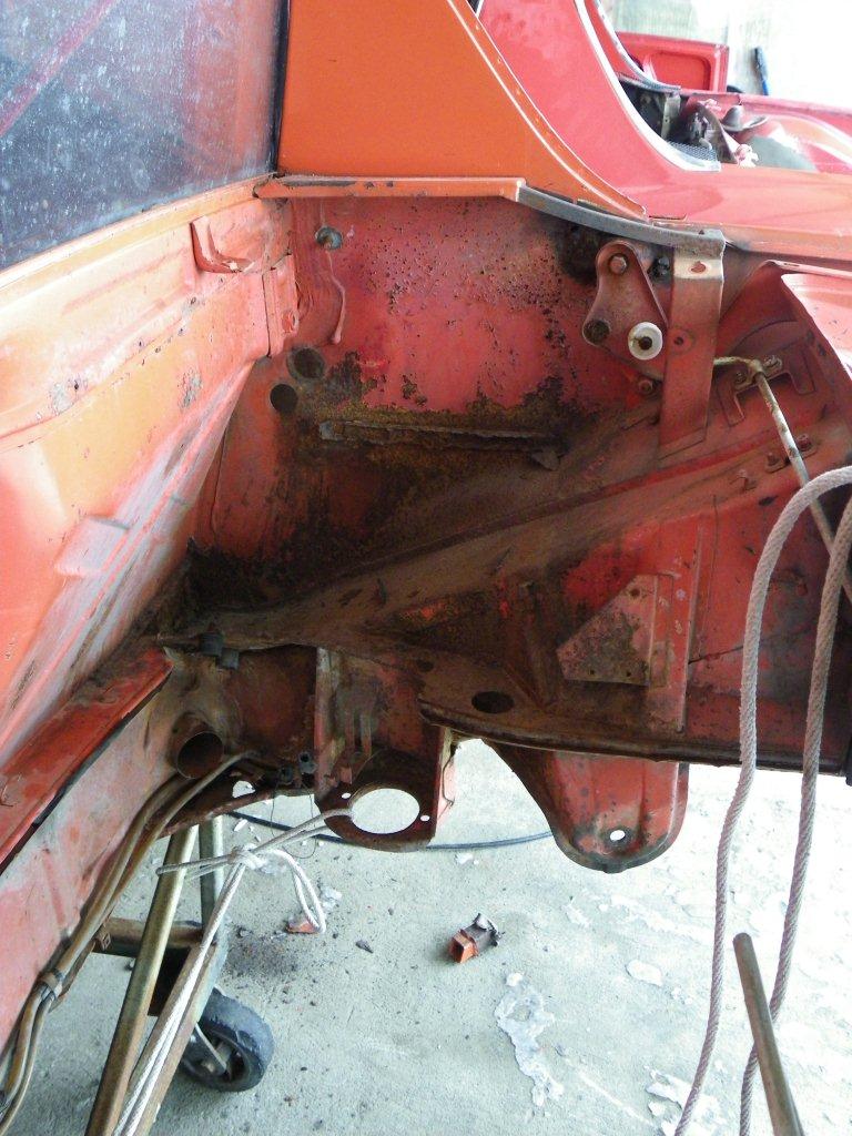

Heres a picture of the hell hole on the red 73', the tar and spray foam covered a whole lot of empty air... and below, the hell hole on the new 72' body I got from Mike and Pete at Restoration Deisgn.. The picture isnt the greatest, but the rust that is there is mostly surface rust. I've tried jamming a screwdriver into it, and its all solid. I';m going to run my die grinder over it and clean it up to see whats what. I'll clean up and replace as required where the battery tray goes and replace the engine shelf ofcourse, but structurally its solid and straight. Thanks again Pete !!
