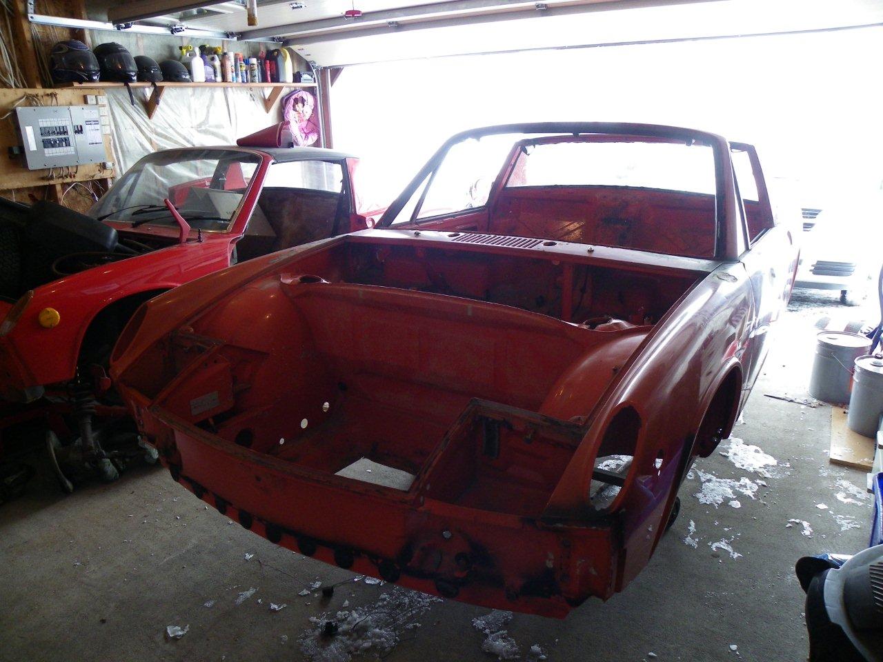

MrHyde   Soo.... I havent posted in a bit but I wanted to w...   Feb 6 2011, 02:41 PM
MrHyde   Heres a picture of the hell hole on the red 73...   Feb 6 2011, 02:50 PM

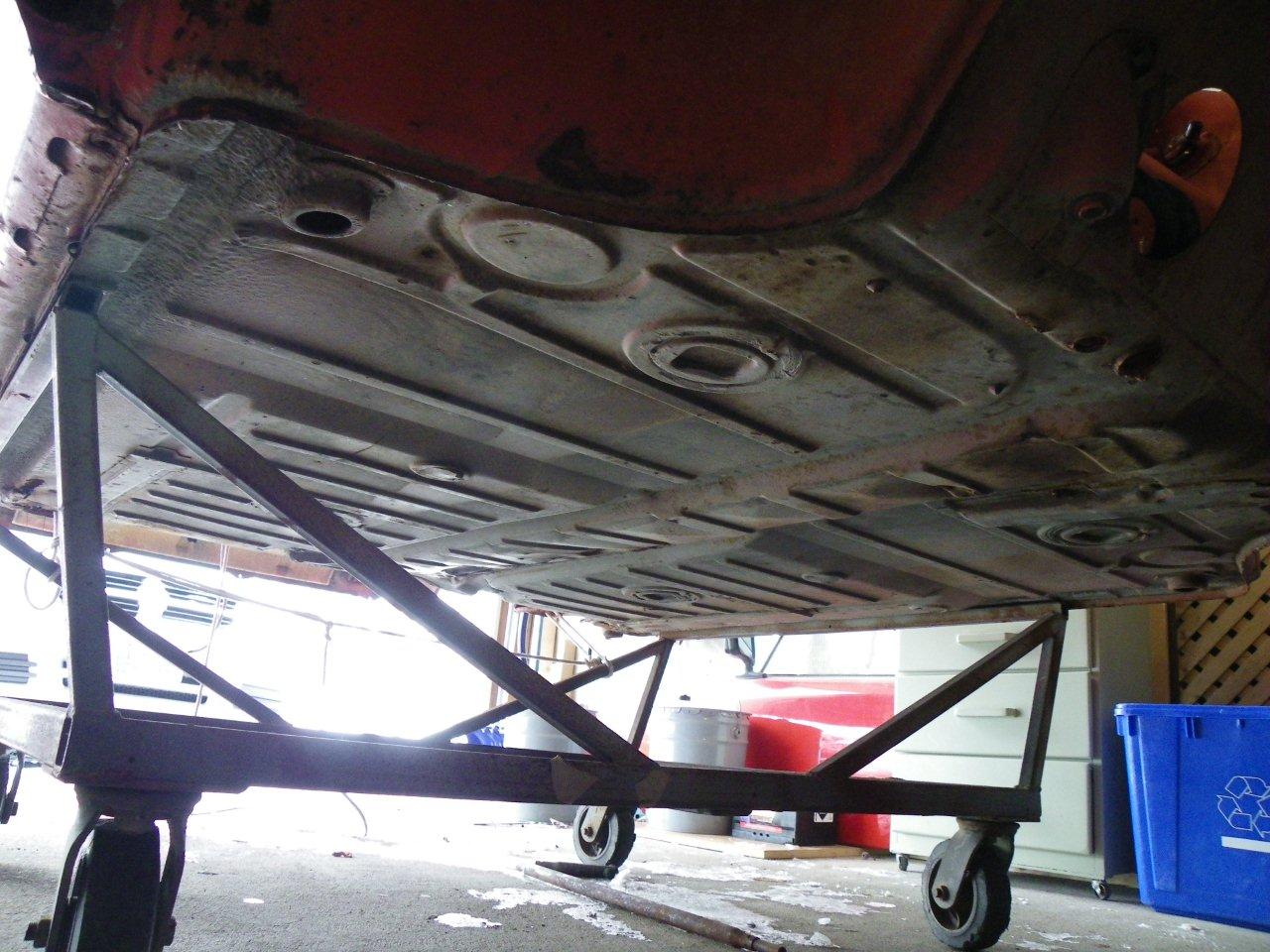

MrHyde   the red 73' in behind.. slowly getting strippe...   Feb 6 2011, 02:58 PM
