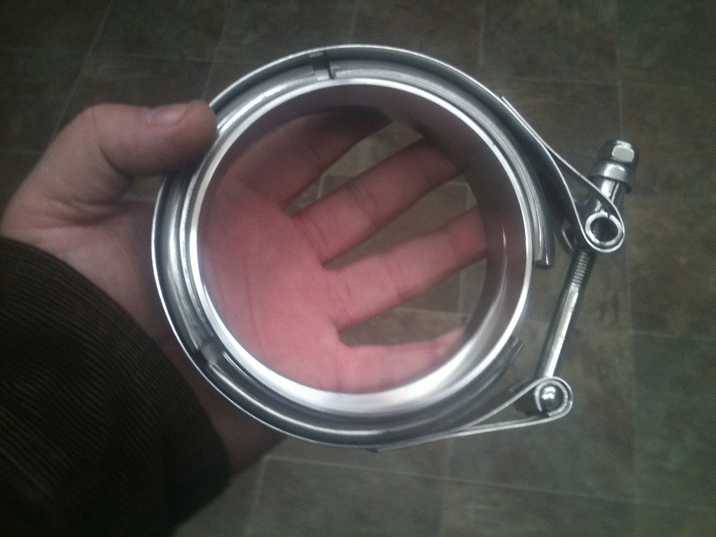

Got my V Band exhaust clamps in... 4 INCHES!!! These things are big! I can slide it up my arm almost to my shoulder.
My turbo oulet is 3" going to a 4" reducer to the first V Band. Then a flex and the exhaust will continue to the Aero Turbine muffler 4040XL, then a simple turn down.

Andyrew   NICE! I love Vband clamps. 4" is Biiiig A...   Feb 17 2011, 08:07 PM
kg6dxn   NICE! I love Vband clamps. 4" is Biiiig ...   Feb 17 2011, 08:20 PM
