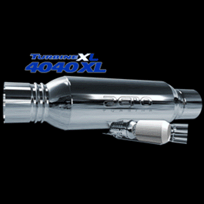

NICE! I love Vband clamps. 4" is Biiiig Are you going to keep it 4"?
muffler?
Mike Bellis
post Feb 17 2011, 08:20 PM
Resident Electrician
Posts: 8,348
Joined: 22-June 09
From: Midlothian TX
Member No.: 10,496
QUOTE(Andyrew @ Feb 17 2011, 06:07 PM) *
muffler?
4 inch all the way. I'm running a seporate small muffler for the waste gate. Not sure which muffler for the WG but this is the muffler for the turbo...
