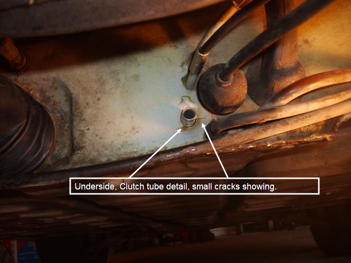

looks like someone may have tried to fix that once before. Here is a pic from a thread about the clutch tube repair that has to be done quite often on these cars.
![]() Hope this helps with your initial question. Do a search for clutch tube repairs and you will find lots of photos of the area in question. Someone will chime in who has actually repaired the throttle cable tube i am sure. Jim |

dr914@autoatlanta.com get thee to a welding shop!. The clutch tube... Feb 19 2011, 10:36 AM![]() ![]() |
