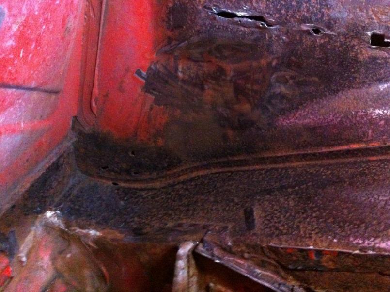

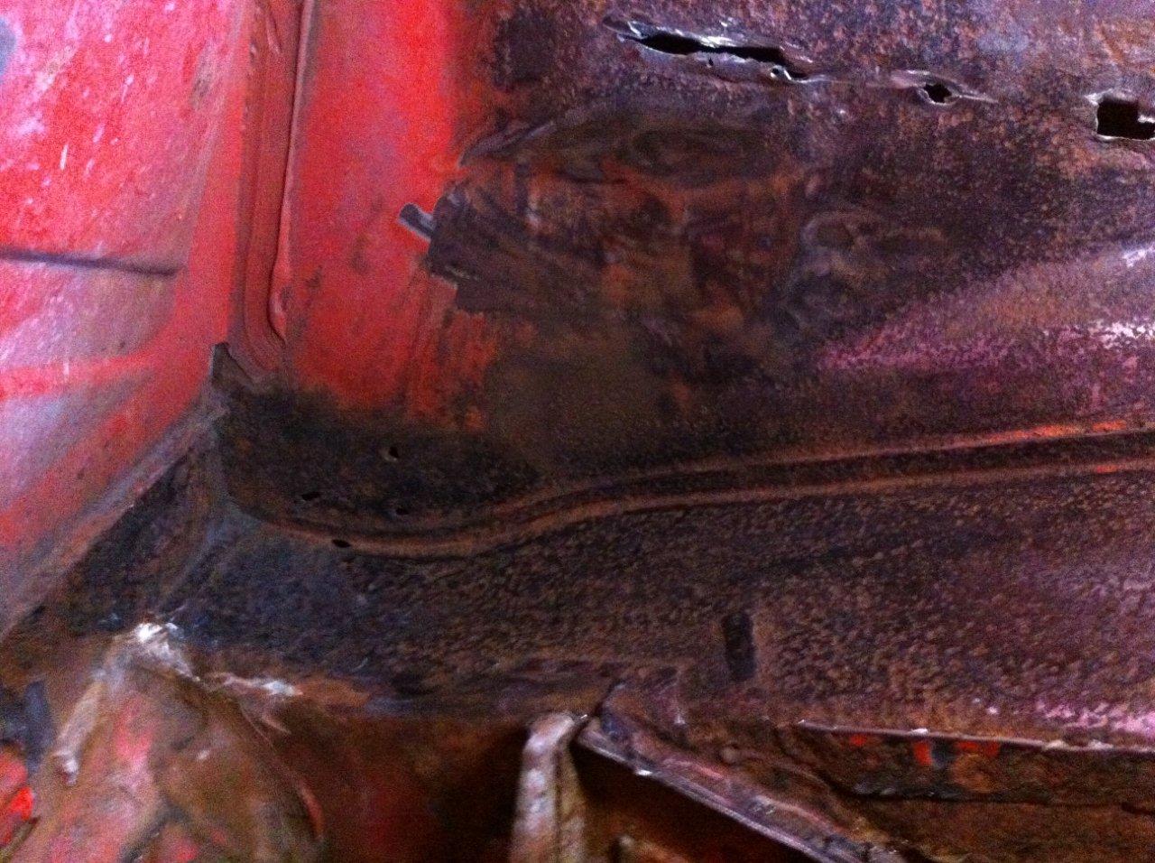

I cleaned the body some more today, removed the old pedals, cables, E-Brake handle and started grinding away at the surface rust in the engine bay.
I've jammed a screwdriver into the hellhole and found a few small holes in the wheel well, but the Longitudinal is solid.. really solid, except for the surface rust and pitting. I'm not sure weather I want to just clean and prep the top of the rear long. and just weld a scab piece over it to double up the steel, or if I should cut out the pitted part and put some new steel in there. The chassis is solid and straight, so I dont know if I want to mess with that, however it would give me a chance to spray some rust preventative down the frame and rocker.
I cut off the remains of the battery tray and put a few small holes into the wheel well, so I'll patch those as well as the A/C line holes that are there.
I'll post a pic of the area, but its a bit dark.
