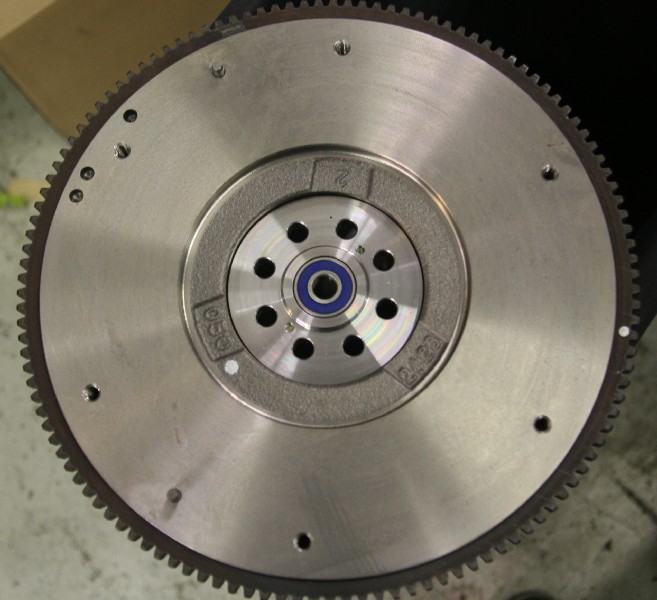

Forgive me for my ignorance about the SVX motor. From what I have read, they are all automatics. Are they drilled for a pilot bearing? Or did you have to drill the crank?
-- brett
BIGKAT_83
post Feb 24 2011, 12:59 AM
Posts: 1,800
Joined: 25-January 03
From: Way down south Bogart,GA
Member No.: 194
QUOTE(bfrymire @ Feb 23 2011, 09:32 PM) *
-- brett
The pilot bearing is mounted to the fhywheel on a Subaru.

69dblcab   Thanks for the info. Where did you get your flywhe...   Feb 25 2011, 06:09 PM
BIGKAT_83   Thanks for the info. Where did you get your flywh...   Feb 25 2011, 06:40 PM
bfrymire   Thanks for the info. Where did you get your flywh...   Feb 25 2011, 07:25 PM
d914   I believe Bob started with my flywheel and then ch...   Feb 25 2011, 07:53 PM
