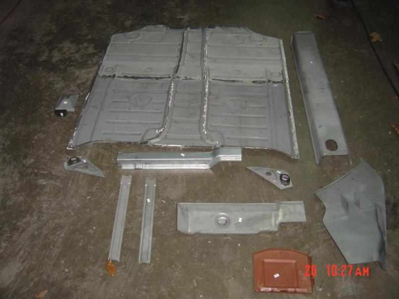

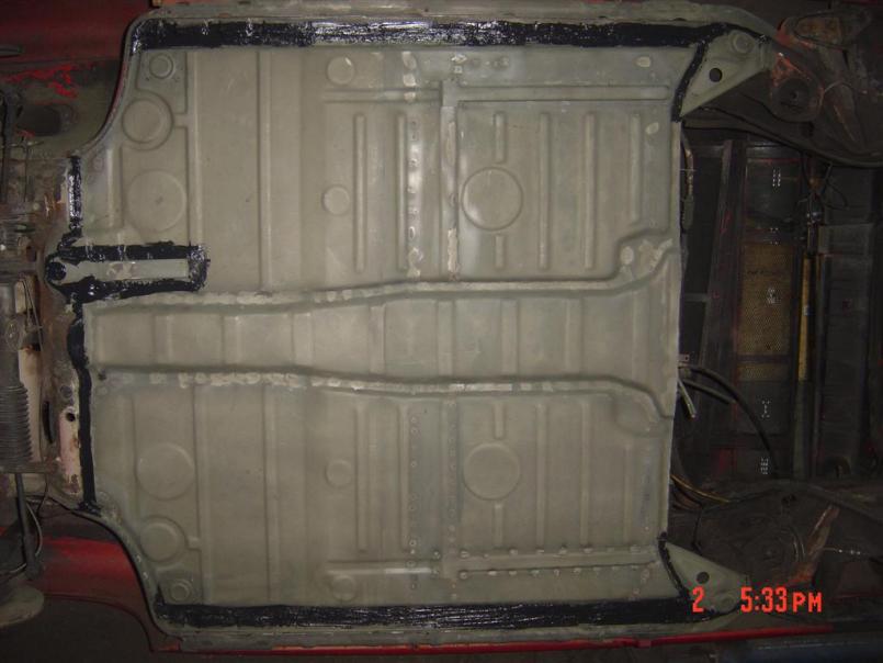

I do basically the same as Perry. Get ti to bare metal ( done ) next step is either coat it with OSPHO which is more readily available to the average consumer. Or give it a coat of etch primer then a coat of selaer. That is my normal routine. After that I use a spray undercoating form a gun, but a good quality spray can will get you good results. I am finishing up a complete floor install tody and had planned on posting some pics for you all of the normal pitfalls you run into. MY bnigets advise to all is to completely remove the under coating, and most importantly the tar boards inside. you never know what is really there until that crap is gone. For cavities, I have a spray wand I got from Strap On that allows me to shoot Ospho into the longs, I let it sit overnight, run water through to clean and neutralize any remnants, let that dry and then coat over it with Eastwoods rust encapsuletor.A teaser pic
