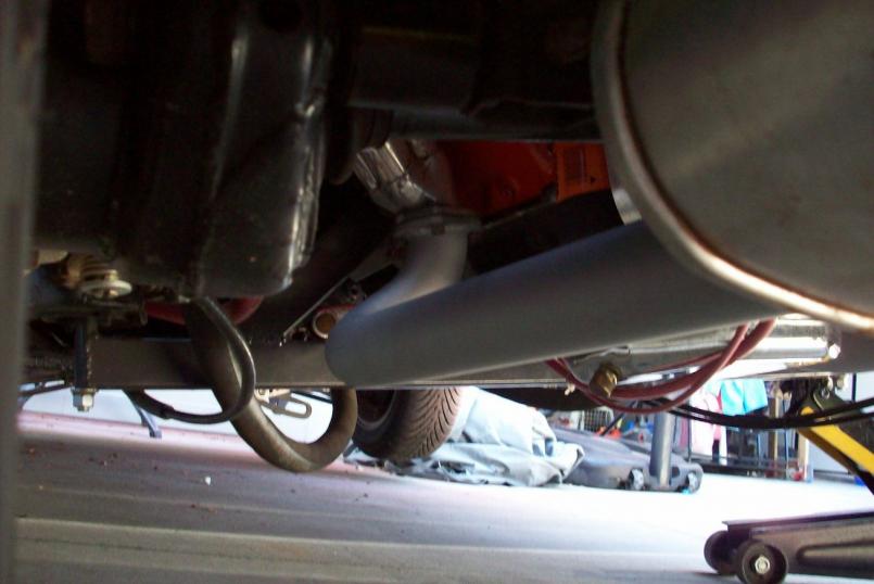

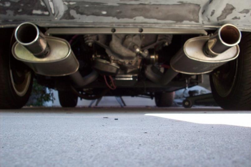

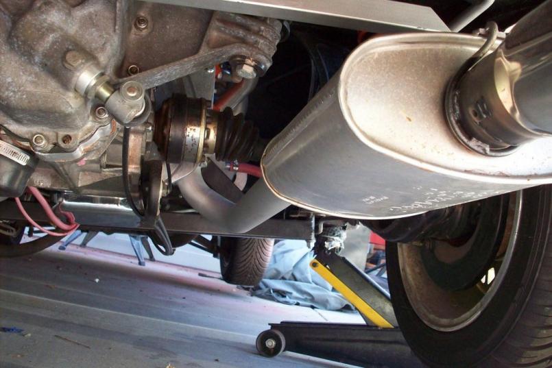

I bought these inexpensive "Raptor" mufflers on Ebay for about $50 and the resonator tips for $10. The mandrel bends and tubing were also Ebay for less than $100. Just took some cutting, welding and grinding. (IMG:style_emoticons/default/welder.gif) The exhaust ended up being a fun part of the project.
