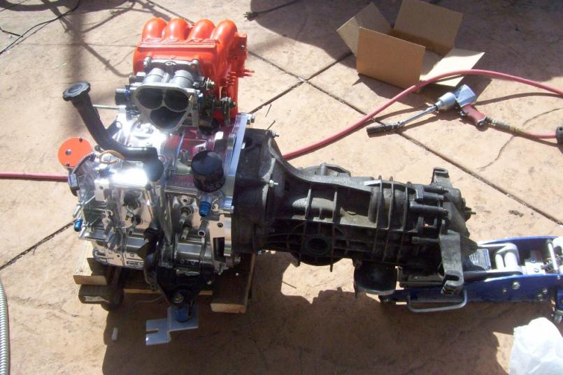

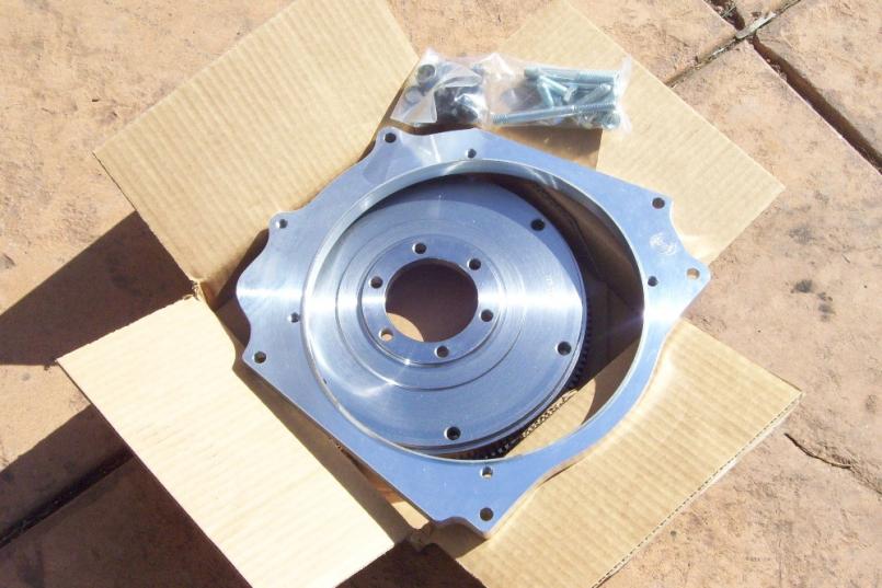

My adapter showed up. Now i can finish the fab of the motor mounts. I bolted my core tranny to it for fitting purpose.
