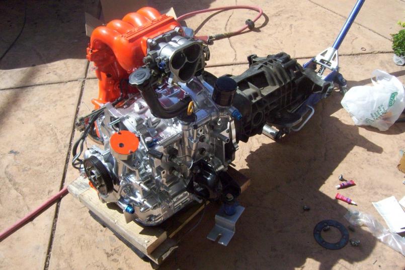

kg6dxn   I finally got my engine mount finished and install...   Mar 20 2011, 04:48 PM
kg6dxn   Here's another pic. The rain in Cali is really...   Mar 20 2011, 04:49 PM
