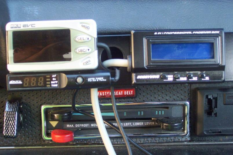

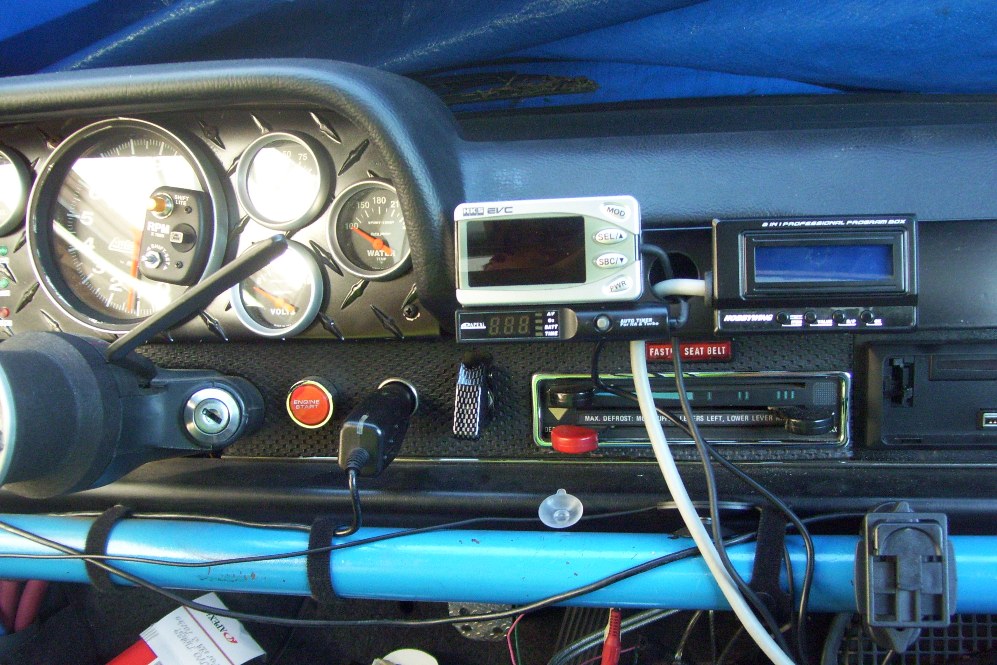

I did some work inside. I welded a bracket that bolts to the existing ash tray mounting screw holes. Mounted are my HKS Boost controller, Apexi Turbo Timer and my oil injection pump controller. I left some extra space to the right for my Navigation maybe.
