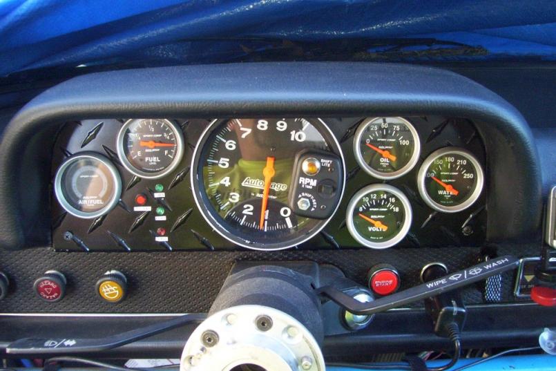

Now I have to figure out where I am putting my boost gauge. Either I redo the dash or find a cool pod for the dash.

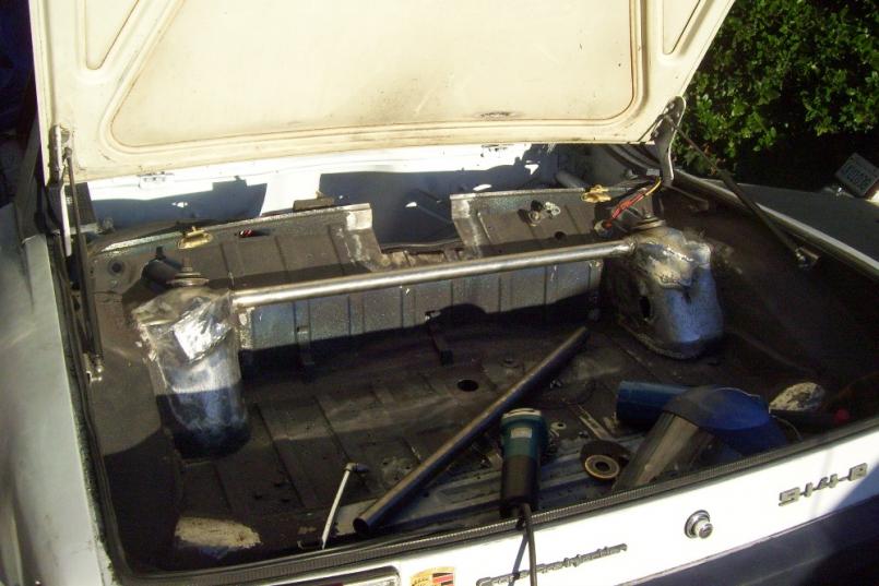

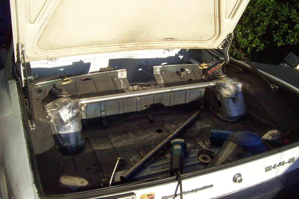

I also cut out the old cage in the trunk to make room for my spaer tire. I found some old damage on the passenger shock tower. I have a donor car in the garage to cut and patch from...

kg6dxn   I did some work inside. I welded a bracket that bo...   Mar 6 2011, 01:18 AM
kg6dxn   Now I have to figure out where I am putting my boo...   Mar 6 2011, 01:23 AM

kg6dxn   Did some more work in the trunk today. Cut out the...   Mar 26 2011, 07:30 PM
kg6dxn   Got it trimed and welded. I also welded in some 1....   Mar 26 2011, 07:33 PM
kg6dxn   Got everything tied in and primered...   Mar 26 2011, 07:35 PM
