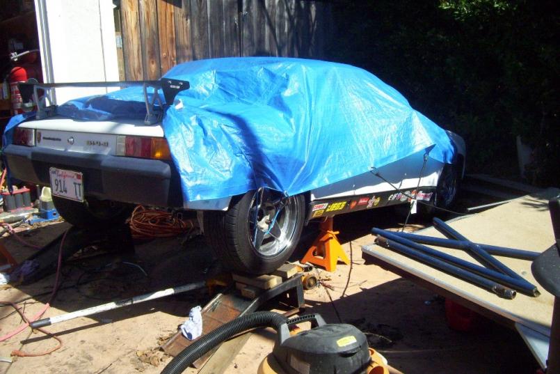

Now for the sad part. My car is outside! I was parting out the car in the garage when my clutch went out and... well... things snow balled into an engine swap...

kg6dxn   Now for the sad part. My car is outside! I was...   Mar 6 2011, 01:25 AM
