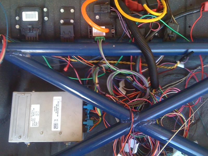

For the historic record, here is an old pic of my rear trunk...

kg6dxn   Thanks for the support guys! For the historic...   Mar 6 2011, 11:46 AM
