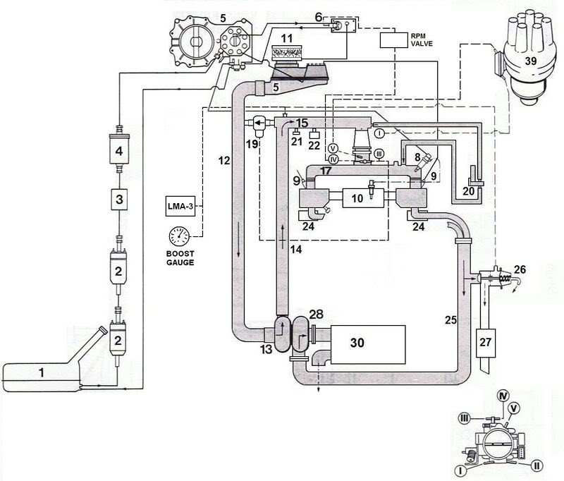

Dr Evil   I had some time this evening to read up on CIS and...   Mar 10 2011, 05:04 AM
rohar   I had some time this evening to read up on CIS an...   Mar 10 2011, 09:15 AM
Dr Evil   Here is a good diagram.   Mar 10 2011, 07:16 AM
Vacca Rabite   you probably already figured this out given the ch...   Mar 10 2011, 08:13 AM
Dr Evil   Thank you captain obvious :rolleyes:   Mar 10 2011, 08:26 AM
