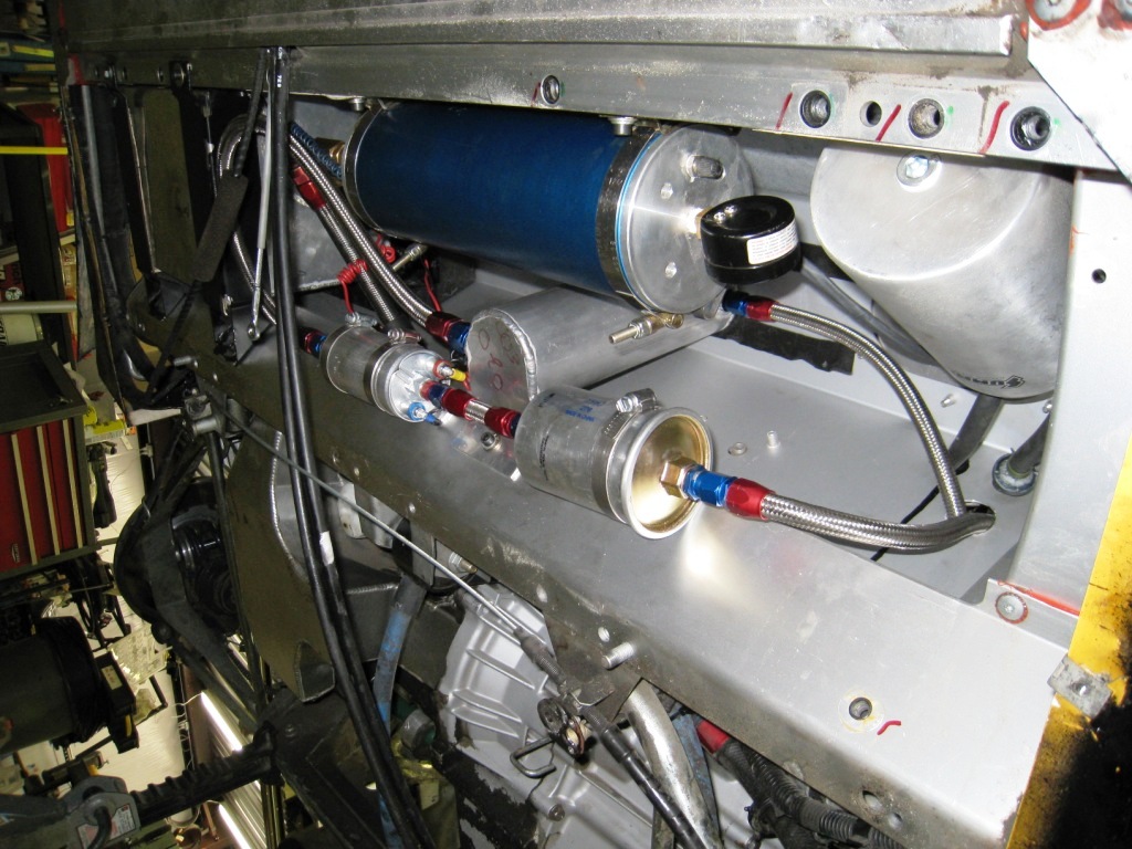

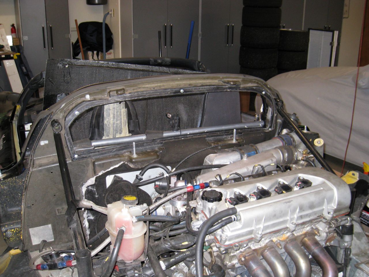

Dr Evil   Here is another one:   Mar 10 2011, 08:37 AM
sean_v8_914   is that a 911 turbo?   Mar 10 2011, 08:43 AM
Dr Evil   No   Mar 10 2011, 09:06 AM
