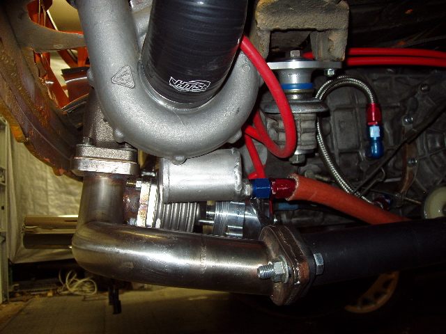

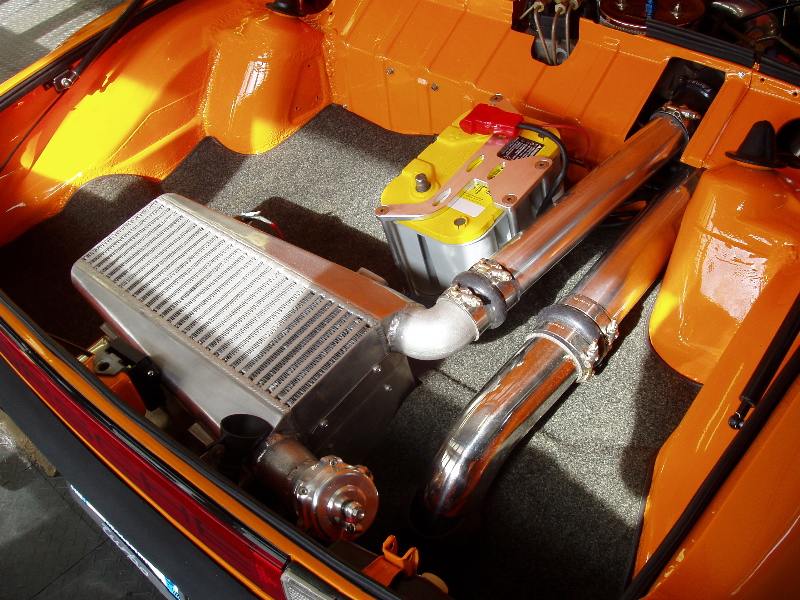

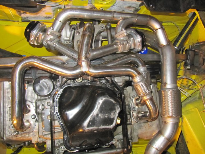

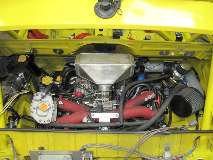

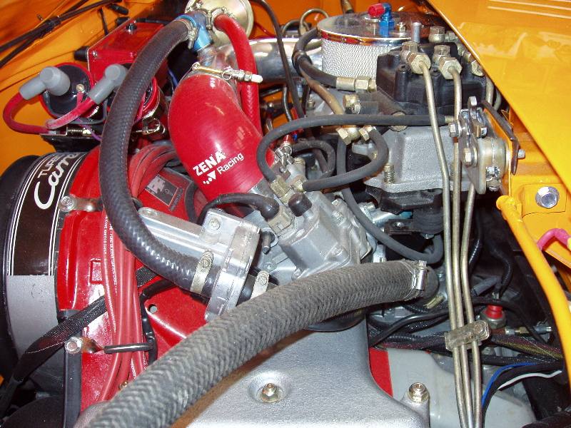

You may note that I said "proper installation". Apparently that means different things to different people, including those that will add a turbo anywhere in the exhaust system then bitch about turbo lag.
Here's a couple pics of "proper installation". You want complexity?..... you can find it here.

QUOTE(J P Stein @ Mar 10 2011, 10:00 AM) *
Who's complaining........ (IMG:style_emoticons/default/confused24.gif)
