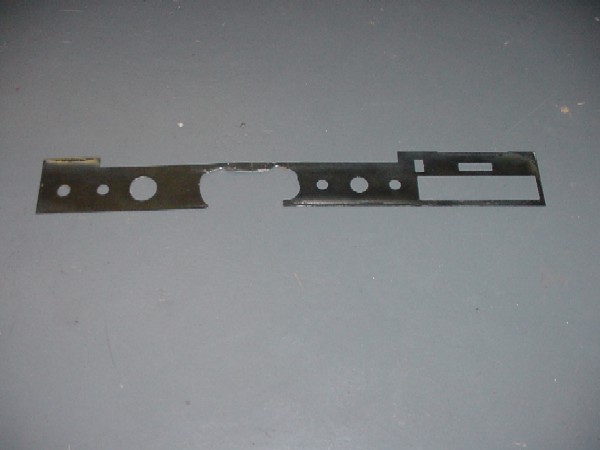

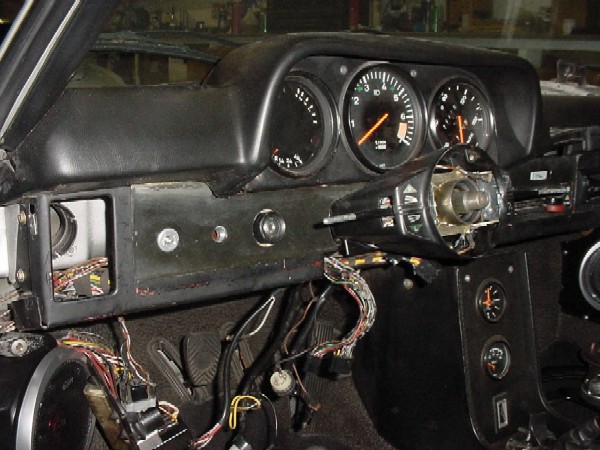

A little more progress and it lives! I started the car tonight with the new (old) ignition switch.
This is the modified dash face.

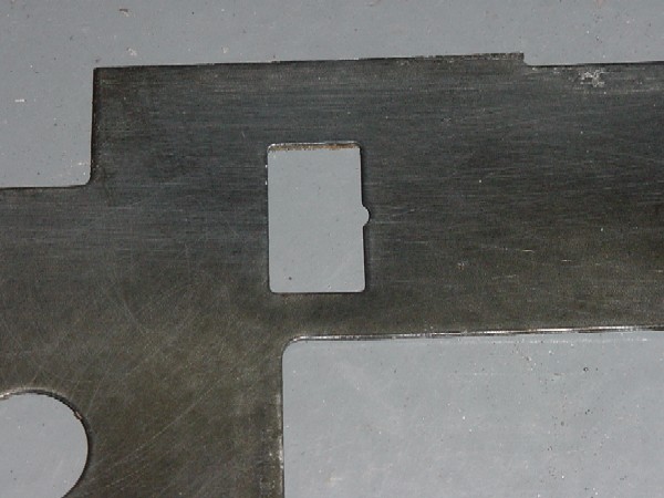

What is/was this switch cutout for? It is original.

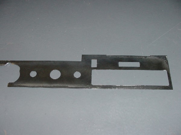

This one shows the location of the mystery switch hole. (There is no hole in the dash that corresponds to this)

jaxdream   That cutout may be for the old style dash mounted ...   Mar 13 2011, 09:08 AM
SirAndy   That cutout may be for the old style dash mounted ...   Mar 13 2011, 05:18 PM
type47fan   Headlight cleaner/washer option "spray contro...   Mar 13 2011, 12:04 PM
John   I believe that Wayne nailed it. Headlight washers...   Mar 13 2011, 08:49 PM
