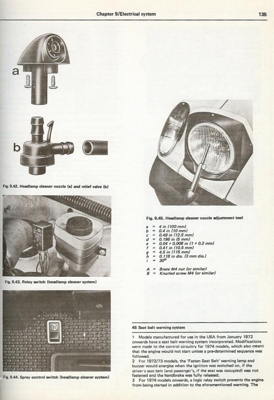

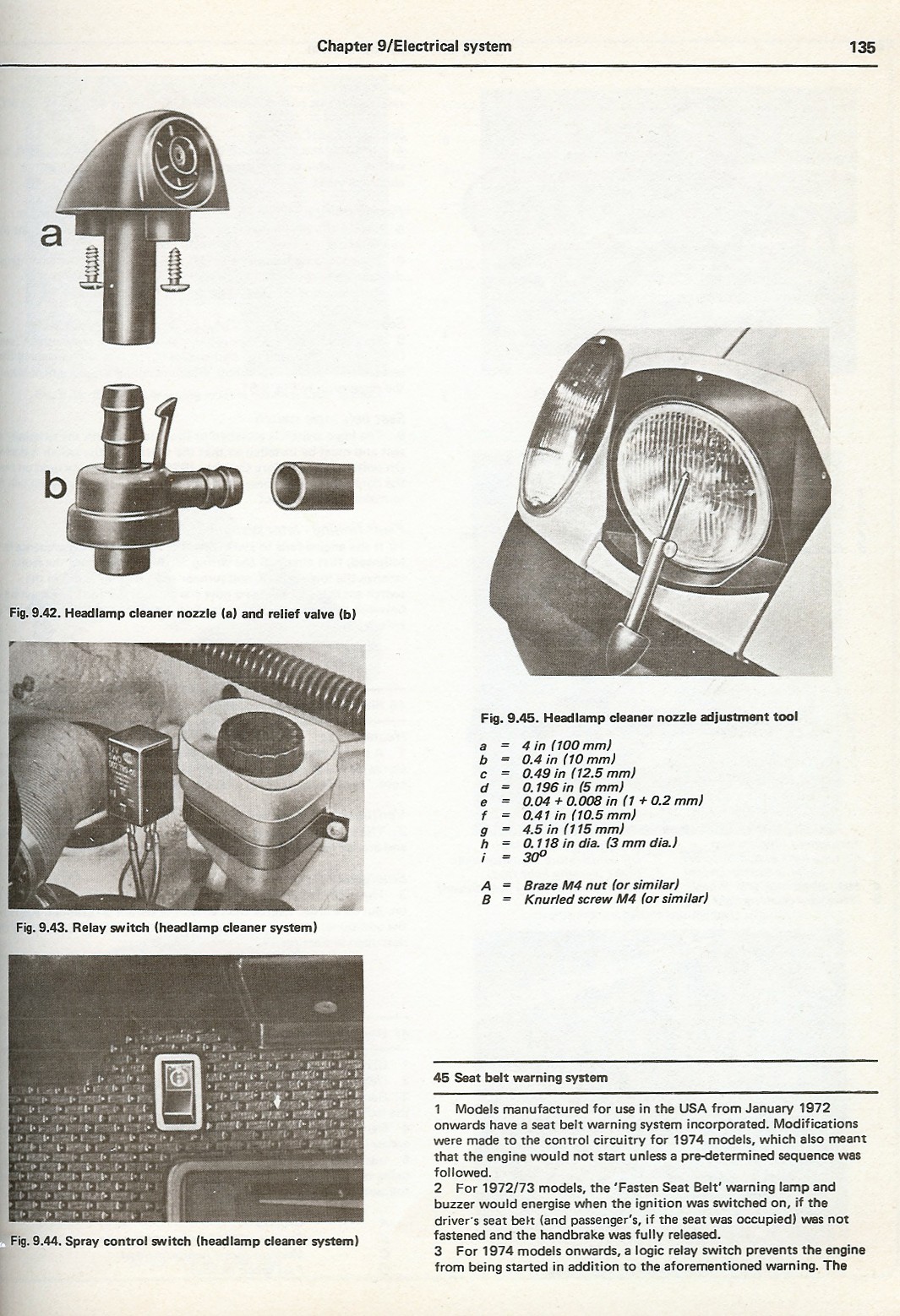

Headlight cleaner/washer option "spray control" switch. (photo from Hayne's 914 repair manual)

jaxdream   That cutout may be for the old style dash mounted ...   Mar 13 2011, 09:08 AM
SirAndy   That cutout may be for the old style dash mounted ...   Mar 13 2011, 05:18 PM
type47fan   Headlight cleaner/washer option "spray contro...   Mar 13 2011, 12:04 PM
John   I believe that Wayne nailed it. Headlight washers...   Mar 13 2011, 08:49 PM
