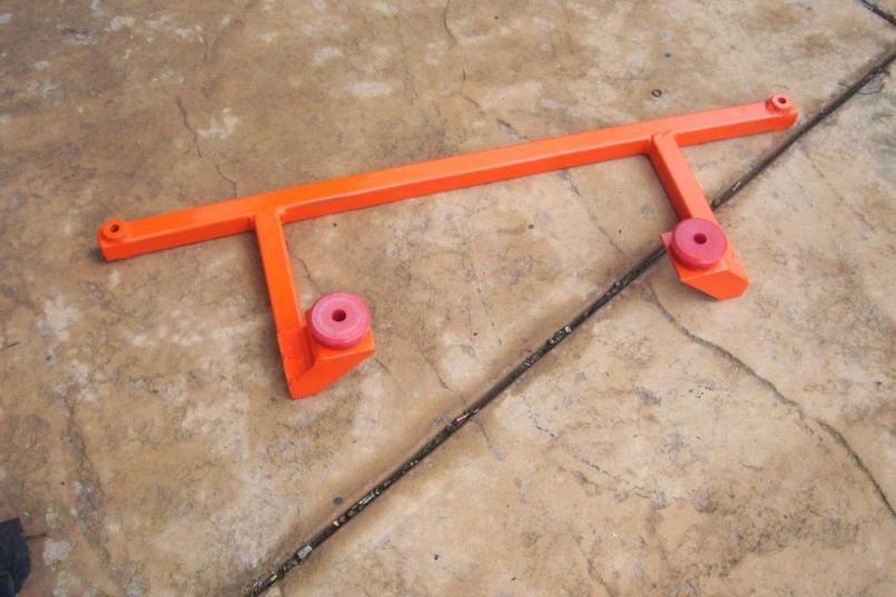

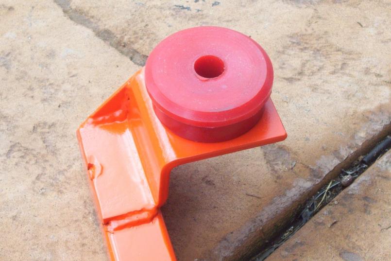

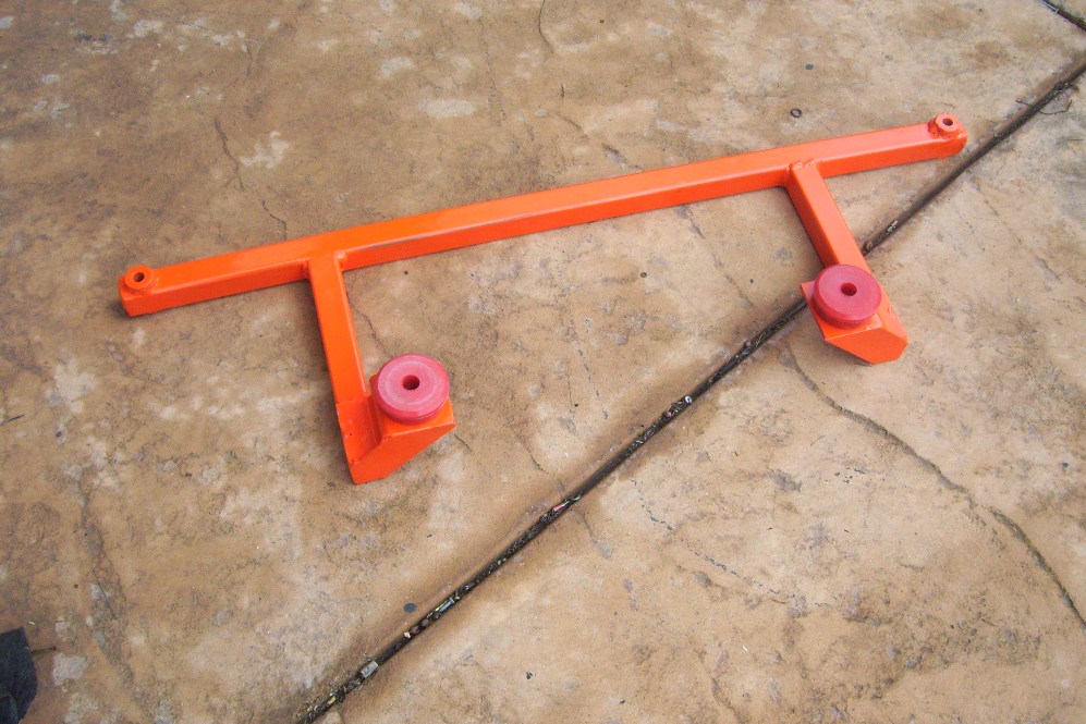

post Mar 20 2011, 04:48 PM
Resident Electrician
Posts: 8,348
Joined: 22-June 09
From: Midlothian TX
Member No.: 10,496
I finally got my engine mount finished and installed. The welding was complete two weeks ago. Paint last week and install today. I built it with 1.25" square tube 0.120 wall and some 1/4" steel plate. Then covered it with VHT orange/red. The bushings are high durometer poly from an old project.
