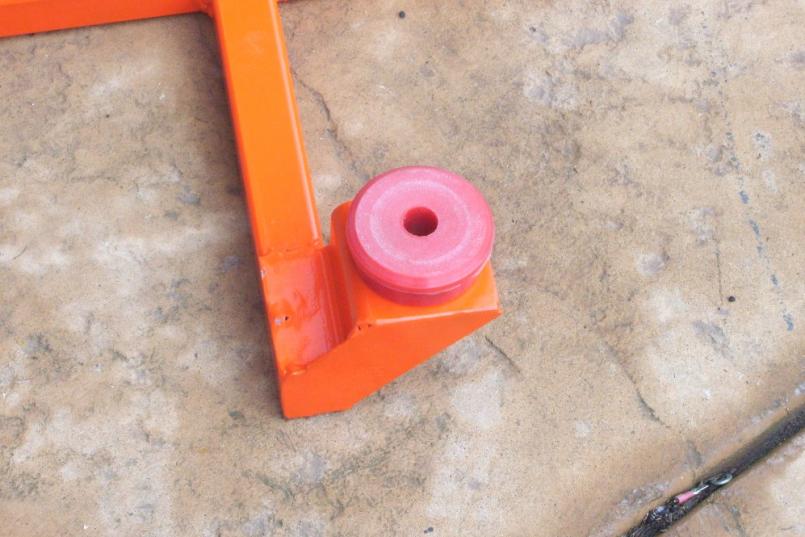

kg6dxn   I finally got my engine mount finished and install...   Mar 20 2011, 04:48 PM
kg6dxn   Here's another pic. The rain in Cali is really...   Mar 20 2011, 04:49 PM

kg6dxn   I beefed up the engine mounts with some 14ga steel...   Mar 27 2011, 08:30 PM
