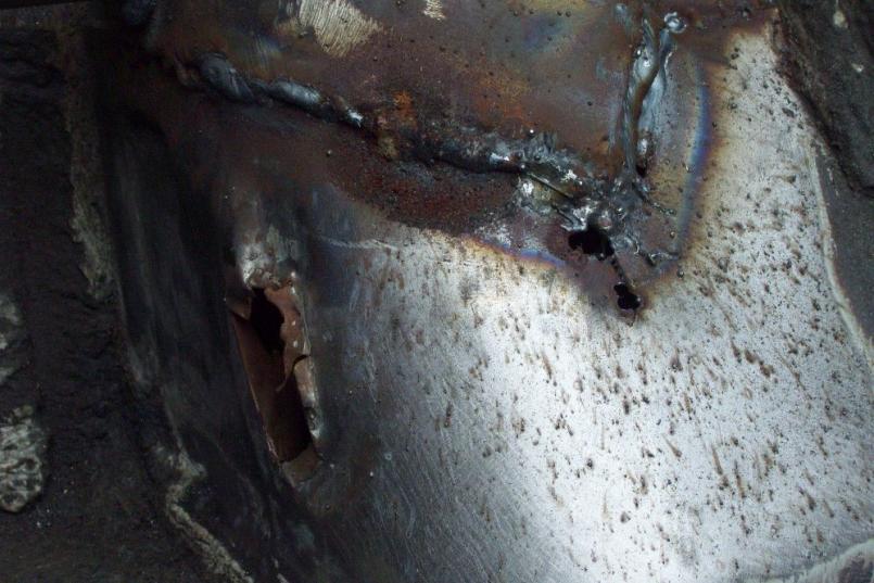

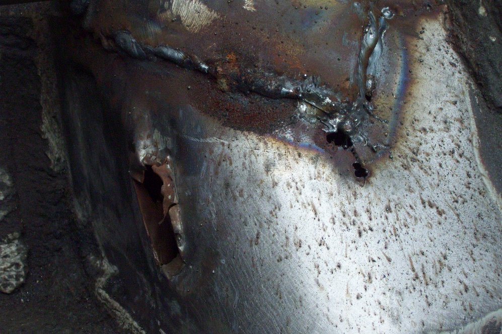

Goober welds... Before I added gas to my mig welder... I have a patch panel for this. I suspect the PO lost a shock or spring. super thin on the back side...

kg6dxn   Goober welds... Before I added gas to my mig welde...   Mar 20 2011, 07:32 PM
