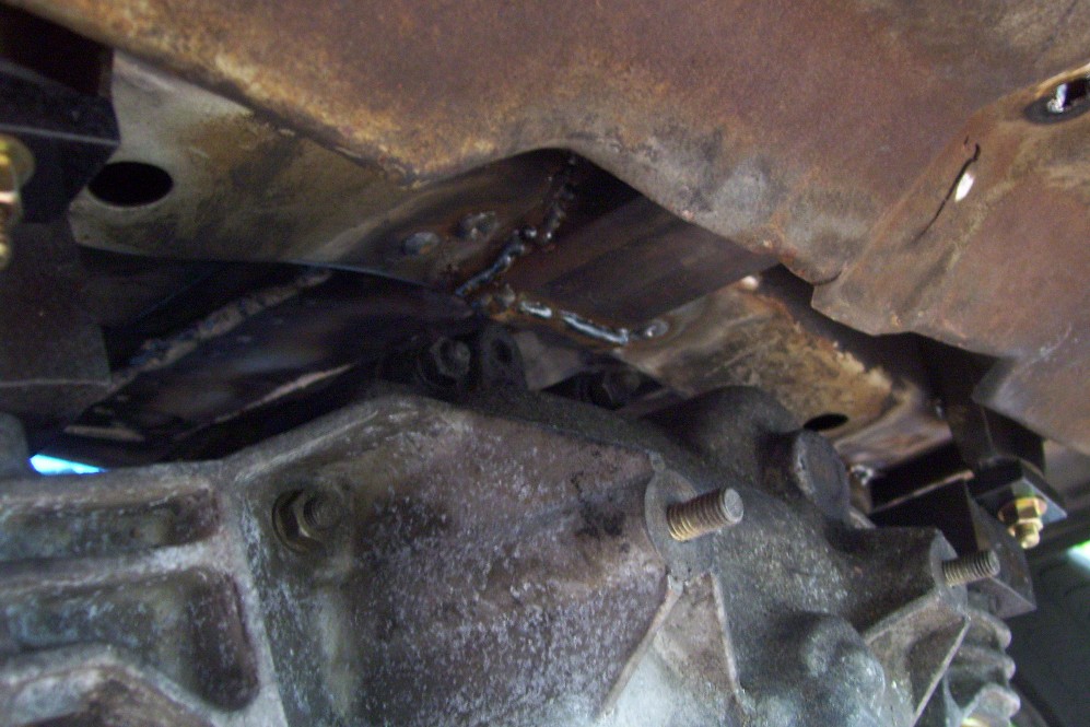

The money shot. Can't even see the motor hardley...
Under the receiver tube... You can see some of the plug welds too...

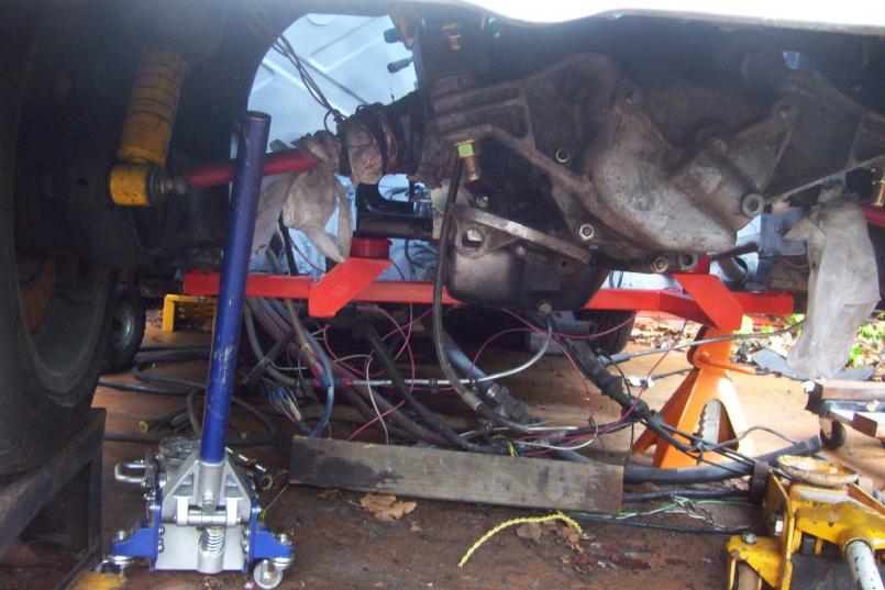

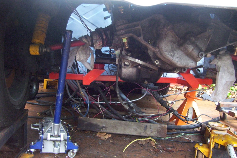

kg6dxn   I finally got my engine mount finished and install...   Mar 20 2011, 04:48 PM
kg6dxn   Here's another pic. The rain in Cali is really...   Mar 20 2011, 04:49 PM
kg6dxn   I have also been working on my trailer hitch. I to...   Mar 20 2011, 07:26 PM
kg6dxn   More...   Mar 20 2011, 07:27 PM
kg6dxn   More...   Mar 20 2011, 07:29 PM
kg6dxn   Goober welds... Before I added gas to my mig welde...   Mar 20 2011, 07:32 PM
kg6dxn   The money shot. Can't even see the motor hardl...   Mar 20 2011, 07:35 PM
