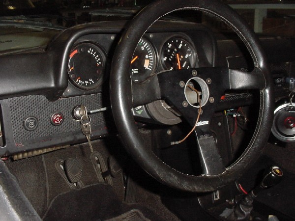

I will convert to a 911 steering column. I have parts for both (with the exception of an early horn contact), and am debating in my head of which one to use.
If I use the early parts, it would "look" more period correct, but the switches just aren't as nice and seem to be harder to come by. If I use the later model 911 parts, I can easily get replacements, but it just won't look the same.
I'm a little biased toward using the early parts, but I'm still "on the fence" when it comes to deciding.

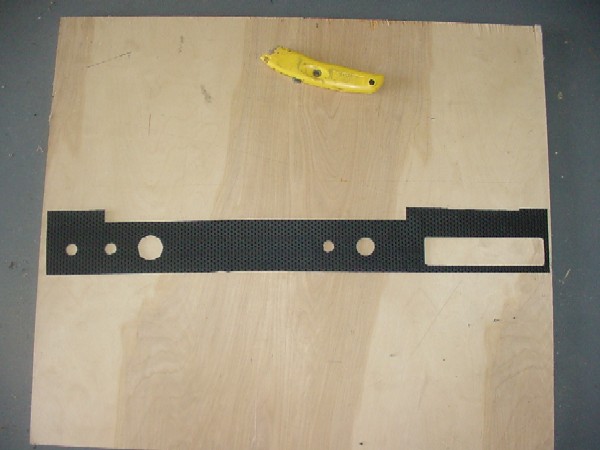

New vinyl
Installed dash face

John   Minor setback. I made my bracket fit my 71 unit b...   Feb 5 2011, 08:57 PM
SirAndy   Who knew the bolt patterns changed between years? ...   Feb 6 2011, 01:20 AM
John   Setbacks. Oh well, it's just cutting welding ...   Feb 6 2011, 04:33 PM
SirAndy   I'm moving the fog light switch to the other s...   Feb 6 2011, 05:01 PM

John   A little more progress and it lives! I starte...   Mar 12 2011, 11:23 PM
jaxdream   That cutout may be for the old style dash mounted ...   Mar 13 2011, 09:08 AM
SirAndy   That cutout may be for the old style dash mounted ...   Mar 13 2011, 05:18 PM
type47fan   Headlight cleaner/washer option "spray contro...   Mar 13 2011, 12:04 PM
John   I believe that Wayne nailed it. Headlight washers...   Mar 13 2011, 08:49 PM
John   Getting closer...... New vinyl Installed dash ...   Mar 20 2011, 09:20 PM

John   After getting everything back together, I did more...   Mar 23 2011, 07:14 PM
John   Wrapped it up today.   Mar 26 2011, 08:13 PM
