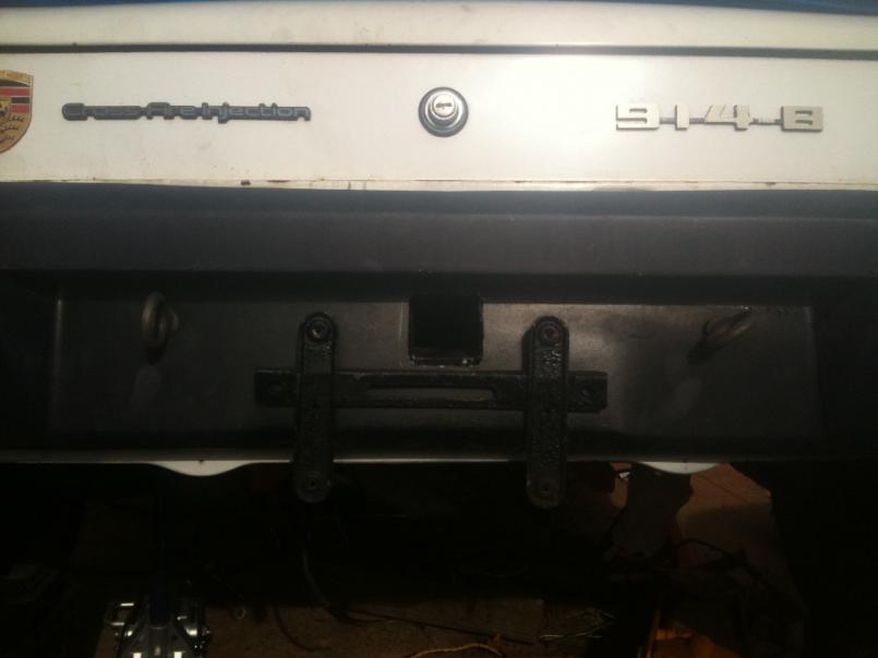

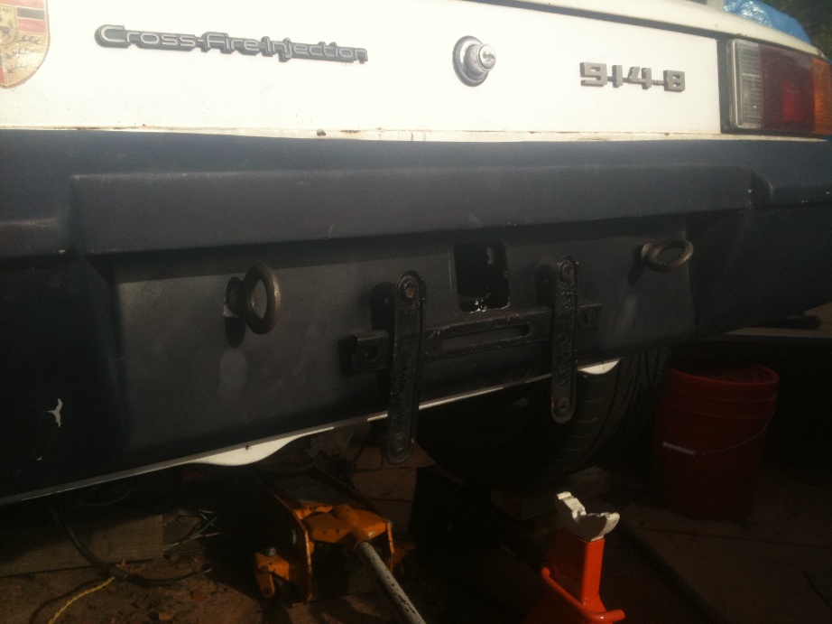

Tossed the bumper on for some quick pics. The old plate holder is shown. The new spring loaded plate holder will hide the receiver hole when not in use...

kg6dxn   Tossed the bumper on for some quick pics. The old ...   Mar 21 2011, 10:13 PM

Andyrew   Looks Awesome Mike! One of those mods that I ...   Mar 22 2011, 08:24 AM
