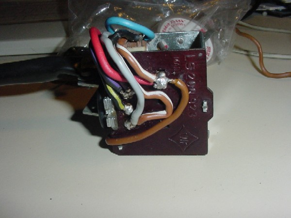

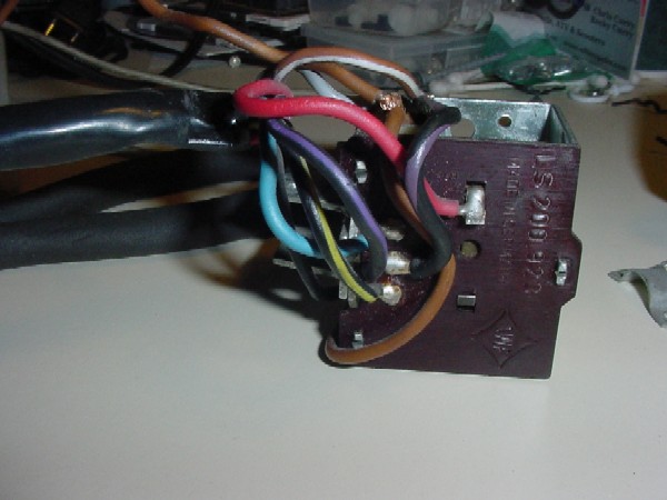

After getting everything back together, I did more testing and found that my results with the wiper switch were a bit less than desired.
After many blown fuses and much talking like a sailor, I did some surgery on my early switch to make it like the diagrams that I have available to me.
My problems were many. I did have high speed and low speed, but the wipers would simply stop where they were in mid travel. There was no parking. My positions were slow in step 2 and fast in step 3. Nothing happened in step 1.
Here is a before and after picture showing how I re-wired my old switch more like a newer switch. One difference is that on my switch, I use a grey wire where the later model air cooled 911's used a green wire.
Now everything works as desired and I found a way to trigger a single sweep (with washer actuation) by pulling back on the stalk.
BEFORE:
AFTER:
