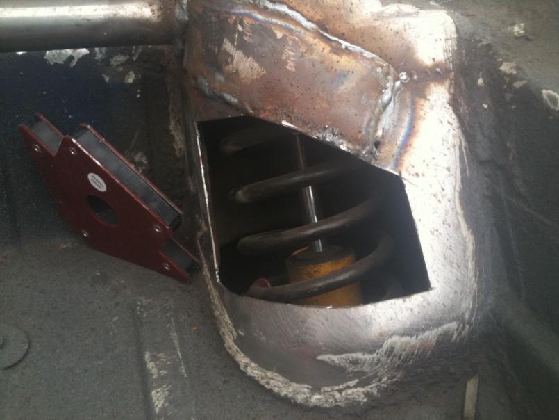

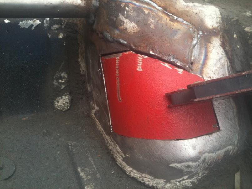

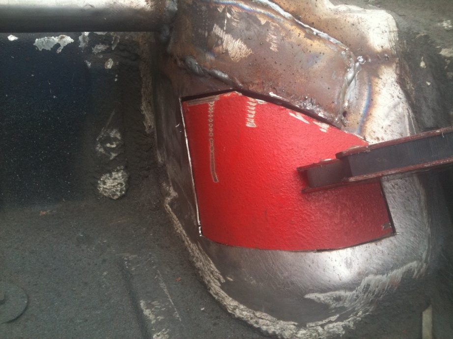

Did some more work in the trunk today. Cut out the damaged section on the tower. Cut a patch from the red car in the garage.

kg6dxn   Got it trimed and welded. I also welded in some 1....   Mar 26 2011, 07:33 PM
