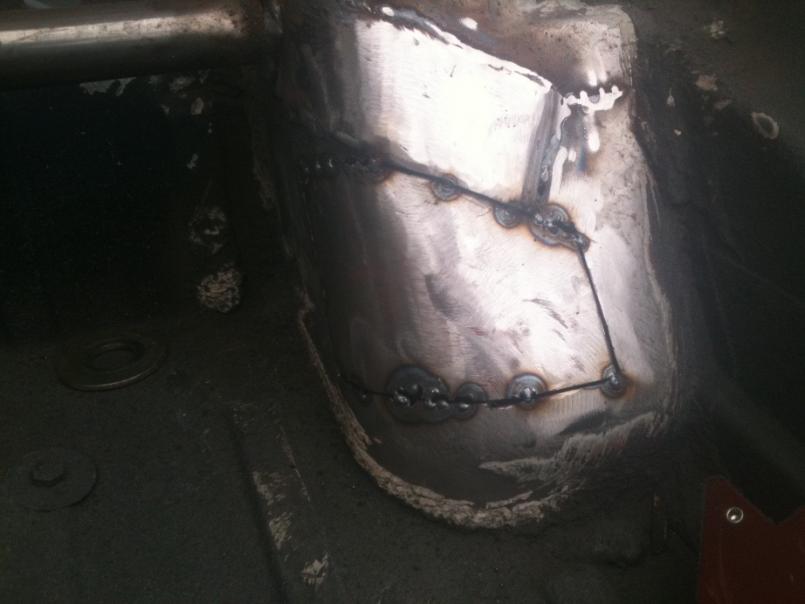

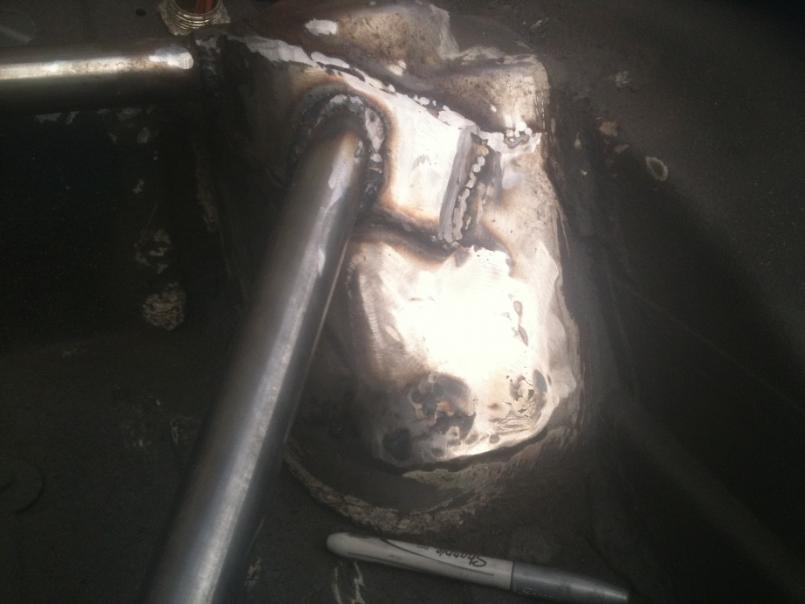

kg6dxn   Did some more work in the trunk today. Cut out the...   Mar 26 2011, 07:30 PM
kg6dxn   Got it trimed and welded. I also welded in some 1....   Mar 26 2011, 07:33 PM
