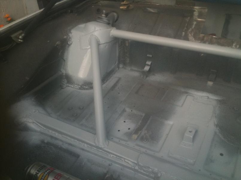

kg6dxn   Did some more work in the trunk today. Cut out the...   Mar 26 2011, 07:30 PM
kg6dxn   Got it trimed and welded. I also welded in some 1....   Mar 26 2011, 07:33 PM
kg6dxn   Got everything tied in and primered...   Mar 26 2011, 07:35 PM
kg6dxn   Strawman get me thinking about the engine bar moun...   Mar 26 2011, 07:38 PM
kg6dxn   I beefed up the engine mounts with some 14ga steel...   Mar 27 2011, 08:30 PM
