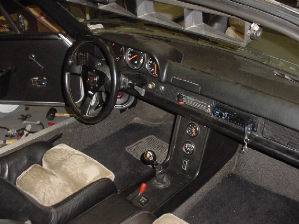

John   A little more progress and it lives! I starte...   Mar 12 2011, 11:23 PM
jaxdream   That cutout may be for the old style dash mounted ...   Mar 13 2011, 09:08 AM
SirAndy   That cutout may be for the old style dash mounted ...   Mar 13 2011, 05:18 PM
type47fan   Headlight cleaner/washer option "spray contro...   Mar 13 2011, 12:04 PM
John   I believe that Wayne nailed it. Headlight washers...   Mar 13 2011, 08:49 PM

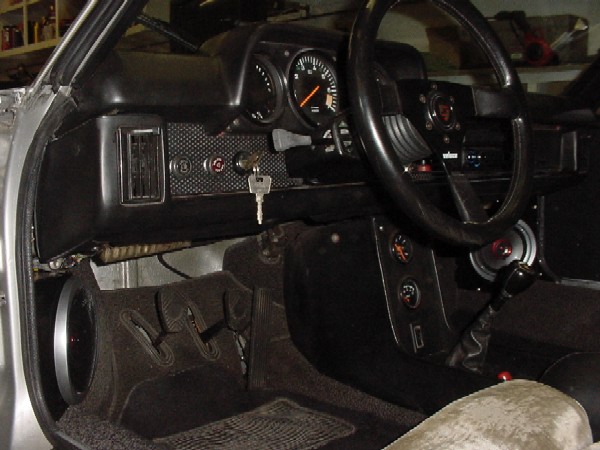

John   Getting closer...... New vinyl Installed dash ...   Mar 20 2011, 09:20 PM
dflesburg   Great Job, now all you need is the early lower das...   Mar 21 2011, 06:44 AM
John   Great Job, now all you need is the early lower da...   Mar 21 2011, 09:28 PM
dflesburg   cool by me.   Mar 22 2011, 09:46 AM

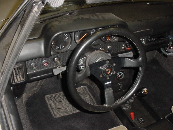

John   After getting everything back together, I did more...   Mar 23 2011, 07:14 PM
John   Wrapped it up today.   Mar 26 2011, 08:13 PM
John   Here is a tool I made and some screws I yellow chr...   Mar 26 2011, 08:17 PM
jaxdream   What is the tool for ???? Jack / Jaxdream   Mar 27 2011, 08:42 AM
John   What is the tool for ???? Jack / Jaxdream I g...   Mar 27 2011, 08:53 AM
