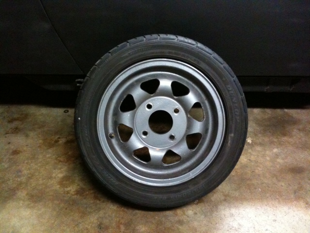

I need to get tires for my 914 that has the american revolution 'empi style' wheel.
what are you guys running? this will be summer performance tires only. im looking for dedicated street tires. thanks in advance -peter |

did you go with the 195-60's ? what are your thoughts? i am gettinf ready to get new tires and am trying to decide between the 195-60 or 195-65. again stock body with Empi 8 spokes. Hey, Sorry for the late reply, I must have missed the post. In my search for tires, I came upon a set of western wheels with 195/50 Dunlop Direzza's with about 50/75% (back/front) tread. And for only $200, it was a steal!!! However, when I mounted them on my car, I didn't realize how small the overall diameter of the wheel/tire combo was and as it sits, it looks a little funny because of the space between the tire and the fender. The fronts are ok, but the back looks weird, So hopefully after I lower the rear end a little it will look good. Despite the looks, the tires are awesome. During my spring break there was a break in the rain and the pavement dried up. the tires really kick ass after they warm up. -peter ![]() |
