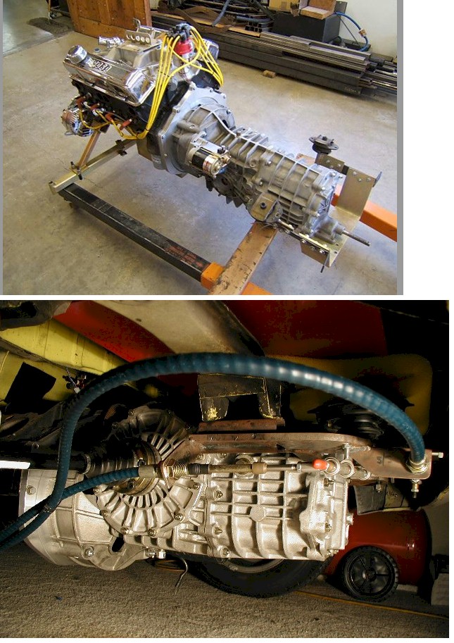

> 930 trans inverted or right side up, cable shifter solution?

Yes, you can flip the diff in a 930, changing the oiling is not hard either, but does take some massaging. I have a 930 box apart if you want pics. I would love to build it and sell it to someone (IMG:style_emoticons/default/idea.gif)
I would even sell it as is as I am not intending on using it. I want a 915 (which is basically the same box, but in a 5 speed configuration).

QUOTE(Dr Evil @ Mar 27 2011, 05:20 PM) *

kg6dxn   I don't think you can flop the ring/pinion so ...   Mar 26 2011, 07:47 PM
jmmotorsports   I don't think you can flop the ring/pinion so...   Mar 26 2011, 08:06 PM
jaminM3   California Motorsports can flip the 930 ring gea...   Mar 27 2011, 10:19 PM
Dave_Darling   I believe the housing has to be machined in order ...   Mar 26 2011, 11:02 PM
John   The case does need to be "clearanced" fo...   Mar 27 2011, 09:07 AM
pcar916   Inverting the 930 is easy to do, it was made with ...   Mar 27 2011, 09:19 AM
jimkelly   at $59.00 each for 108mm cvs - plus, axles, a...   Mar 27 2011, 09:36 AM
pcar916   at $59.00 each for 108mm cvs - plus, axles, ...   Mar 27 2011, 10:41 AM
Dr Evil   Yes, you can flip the diff in a 930, changing the ...   Mar 27 2011, 06:20 PM
jimkelly   pics please doc :worship: what year 930? :ide...   Mar 28 2011, 11:51 AM
jimkelly   info i have seen says the g50 much be installed up...   Mar 28 2011, 04:27 AM
pcar916   info i have seen says the g50 much be installed u...   Mar 28 2011, 11:36 AM
jimkelly   g50 shifts better than a 901 - that is a plus :dr...   Mar 28 2011, 11:49 AM
pcar916   The 930 and the 915 ar very similar (as the Doc ha...   Mar 28 2011, 04:15 PM
jimkelly   another wrinkle in installing a 930 trans is wheth...   Mar 28 2011, 05:26 PM
pcar916   Not a deal breaker. I like the both for different ...   Mar 28 2011, 05:57 PM
