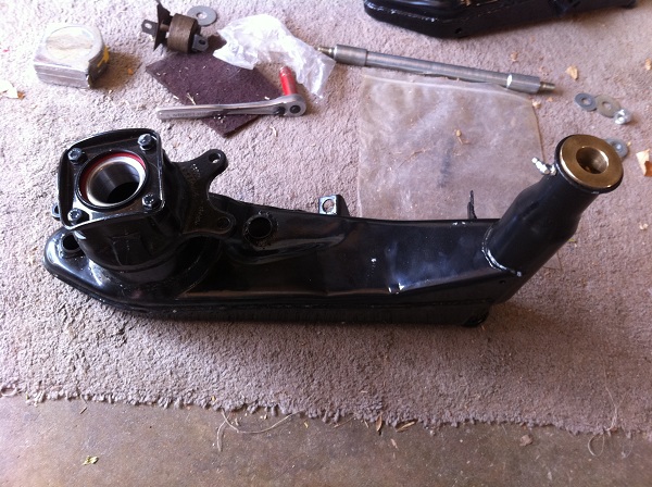

I've been working hard at school, but here is some progress. I finished pressing in the Elephant Racing bronze bushings into the control arm and bolted them back in. To try to preserve the allignment as much as possible I glued the lower bracket back into the same position it came out in, which should line the holes up well enough for me to limp in to get an allignment.

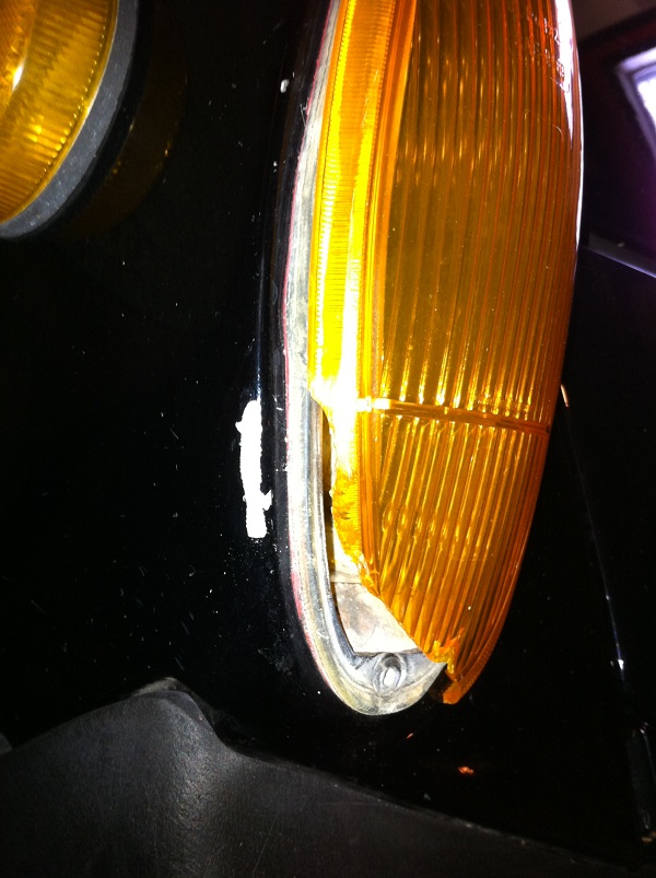

On the downside someone dropped a bike on my teener and broke the front turn signal and put a 1.5" scratch down to bare metal! Grrr!
