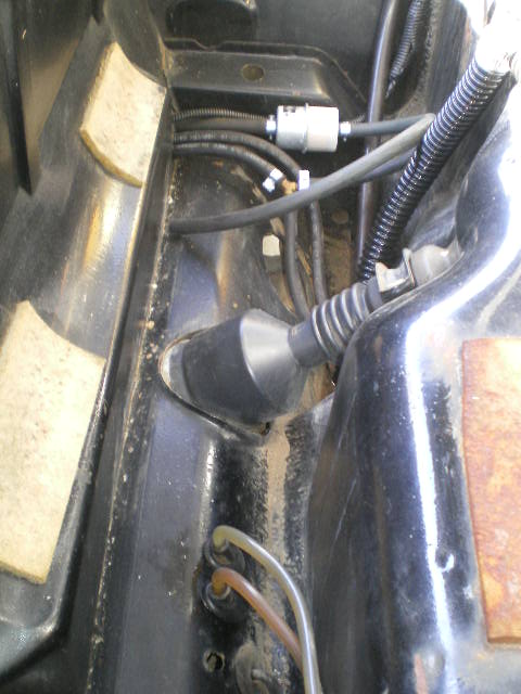

While my drive train is out I decided to do some fuel upgrades. Once I had removed the tank to R&R hoses I decided to upgrade to the 75-76 style sans the 2 port pump. Why? Why spend the extra $$$, now. When this pump goes out I will change to the 2 port style which will require pulling the tank again, but so what. So now that the tank was out I ordered up a set of 8mm SS lines and required appurtanances from Rotary914. On a '73 the fuel lines are different sizes which makes it a little easier to slide on of the new 8mm lines into the grommets. Robert's video suggest 2 men to change these lines out but I had just myself. I found that by removing the shifter base bolts and turning the base 90 degrees I could push/pull the SS lines (one at a time) with a pair of vise grips with one hand while guiding the end thru the front grommet with the other hand. As Robert says in his video, "WD 40 is your friend".
Next was to relo the fuel pump to avoid the vapor locking syndrome. I had asked around and heard both sides but figured this car may be in a hotter climate some day and I'll save the next owner a tow charge. Besides, it's one less fire starter in the engine bay. So as you all know, here was it's home beneath the battery (IMG:style_emoticons/default/lol-2.gif) and adjacent to the hottest burning cylinder and oil cooler (IMG:style_emoticons/default/av-943.gif)
I wanted to locate the pump in the same place as my 76 but it wouldn't work out for me so I located it on the psg side. I was able to re-use the existing shock/vibration mounts. BTW, these are still available thru Aircraft Spruce. The blue tape was just a reference to the spare tire cover/lid so that it would be concealed and out of harms way. I will locate the filter beneath the tank (I know, I know) because I will be pulling the tank in 2 yr's to examine the hoses. As an experiment in longevity, I am using the new Goodyear hose in a side by side test with the German hose. e.g. 5/16" vs. 8mm on gravitational side and 1/4" vs. 7mm on the pressure side.
And the backside. Notice the grommets. You could use some old larger sized hose for this, also.
While I'm at it I will relo the vapor cannister but that's another thread.

I felt ashamed when I saw how dirty that area was so I'm posting a pic after some soap & water.
Edit: I can't imagine why you would need a return.
