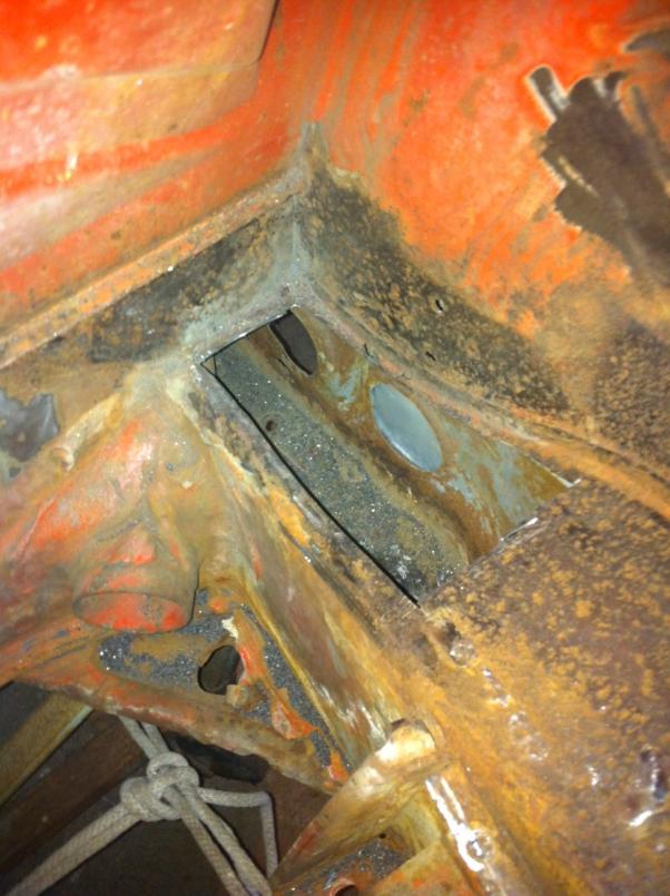

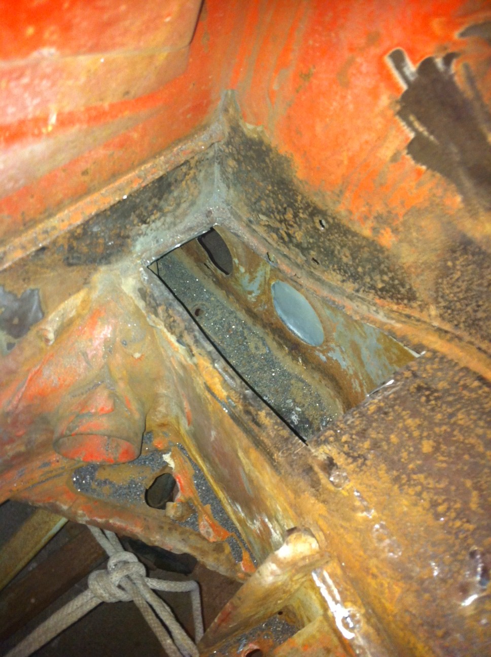

Attached ImageSo Its been a while since I posted last.. I have been cleaning and getting parts together for the hellhole and floors.
I cut out a small part of the frame at the hellhole since it was pitted pretty badly. Found the remains of a mouse house in there, but the frame itself looks pretty good for a 40 year old car. I was just sandblasting the hellhole a bit so it still has the sand all over the place...

MrHyde   inside the frame rail.   Apr 10 2011, 04:54 PM
